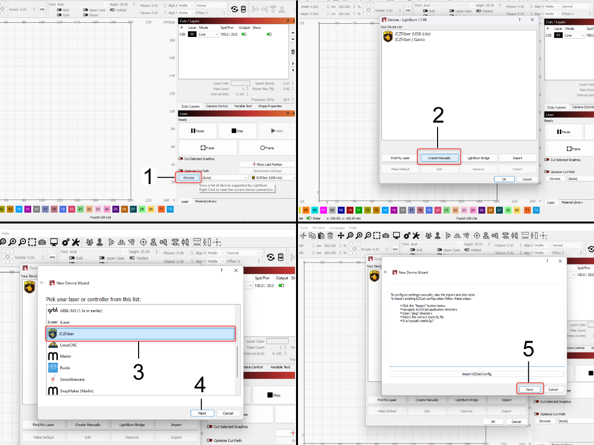

The F290 lens does not have a device profile in LightBurn. You will need to create a device profile for the F290 lens in LightBurn. LightBurn will then save the configurations for the lens in that device profile and will allow you to switch lenses based on the requirements of your project.
Tools Required:
  • Dark Colored Construction Paper (Black is recommended for best results)
  • Caliper
To swap the lens to the F290 F-THETA LENS, you will need to do the following:
  1. Select Devices
  2. Create Manually
  3. Select JCZFiber
  4. Click Next
  5. Click Next

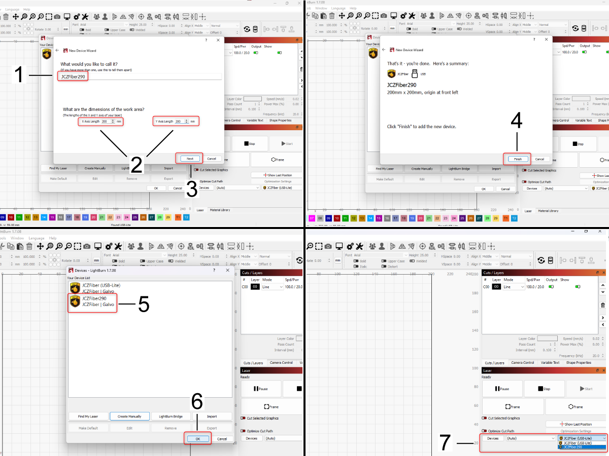

Swapping Lens instructions continued:
  1. Name your laser. We recommend naming it based on the focal length of the lens. Such like JCZ Fiber290
  2. X-axis Length and Y-Axis Length depends on the work area of the lens. For the F290 lens, input the following values:
    X-Axis: 200mm
    Y-Axis: 200mm
  3. Click Next
  4. Check that the Name and the Work Area of the lens is correct and click Finish if it looks ok.
  5. Select the F290 in the device list
  6. Click OK
  7. In the Laser Window, you can see the lenses saved in your device folder. You can select the appropriate lens for your projects in the Laser Window.

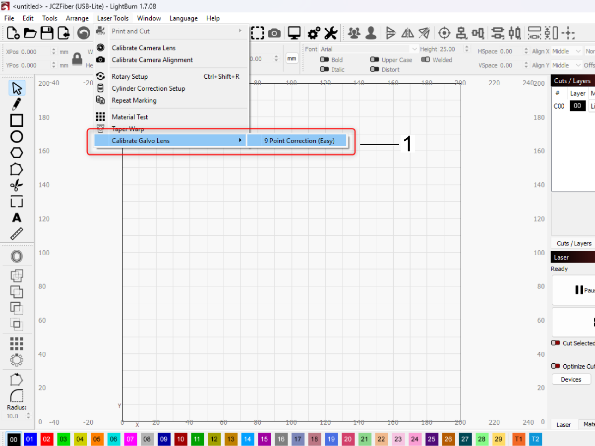

You will need to calibrate the F290 Lens.
To do so, be sure to navigate to the Laser Tools > Calibrate Galvo Lens > 9 Point Correction (Easy).
Follow the steps.
Important: You will need dark colored construction paper (we recommend black construction paper) and a caliper.
Note: Lenses can be switched between the F160 and F290 lens without calibration once the F290 lens is listed in Devices and calibration is complete.
