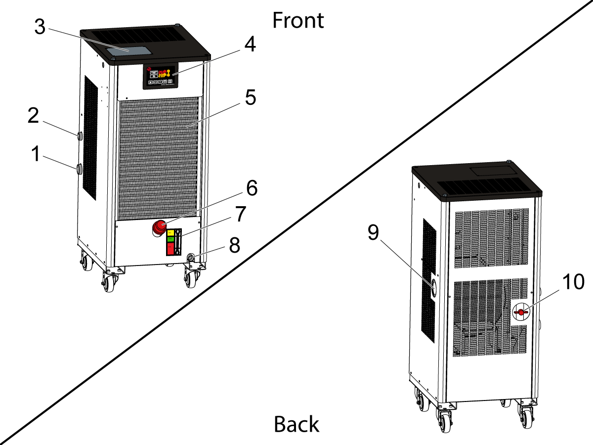

HDC-3-5AX Spindle Chiller Maintenance
This image shows the key components of the Spindle Chiller:
Front of Chiller:
  1. Chiller Fluid Inlet
  2. Chiller Fuild Outlet
  3. Access Panel
  4. Dispaly/Control Keypad
  5. Air Filter
  6. Chiller Fluid Tank Filler
  7. Chiller Fluid Level Gauge
  8. Drain Plug
Back of Chiller:
         9. Pressure Gauge
         10. Drain Value

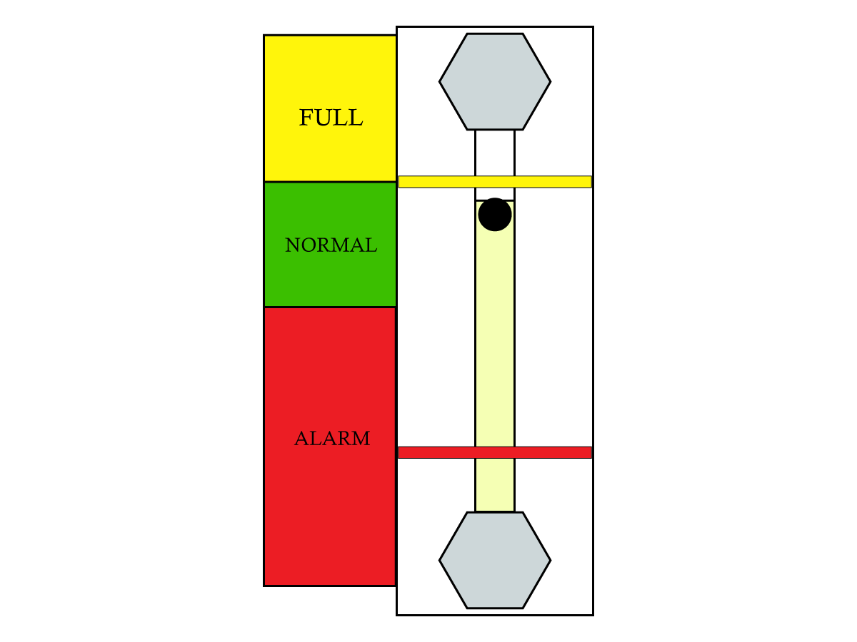

Inspect the fluid tank level by looking at the fluid level gauge located on the front of the spindle chiller [7]. To add fluid to the tank, remove the cap to the inlet at the top of the unit, and fill the tank with a mixture of 30% ethylene glycol and 70% dionized water until the gauge reads the level is at the top of the NORMAL or at the FULL level.
To clean the air inlet filter, remove the grate to gain access to the filter unit. From there, remove the filter screen so that any dust or debris can be picked out of the filter. If necessary, wash the filter using water to get rid of contaminants.
Make sure that the air outlets are clear of dust and debris. It is also recommended to allow a clear area of 12 inches directly behind the air outlet vents. This will allow for proper air circulation in the system.

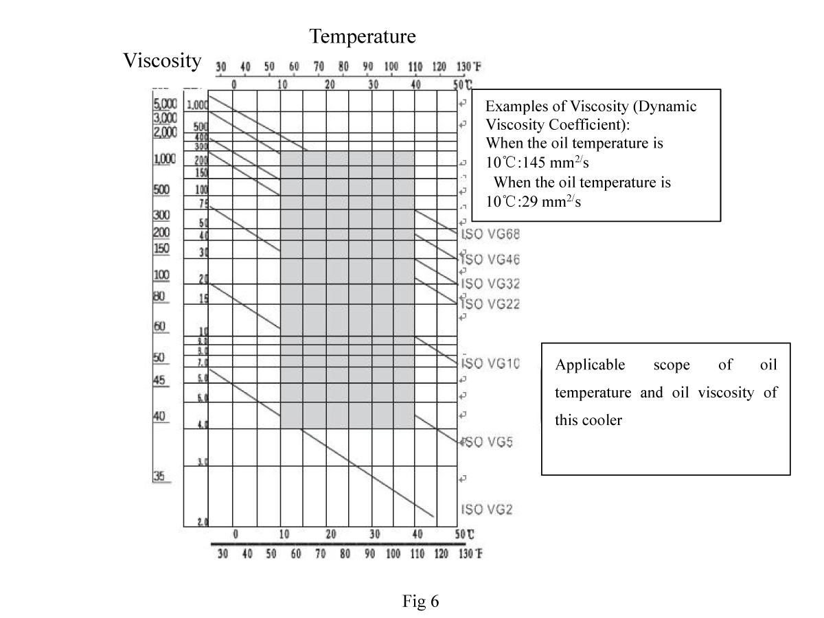

Applicable oils
  1. This chiller is recommended to use mineral hydraulic oil and lubricating oil. Do not use the following liquids:
    • Ortho-ester oil pressure oil, chlorinated hydrocarbon oil pressure oil, water-ethylene glycol fermentation oil pressure oil and O/W, W/O emulsified oil pressure oil and other non-combustible as load oil:
    • Cutting oil grinding oil water and water soluble liquid;
    • Food, medicine and corrosive liquids;
    • Gasoline, lamp oil and organic solvents;
  2. The viscosity of oil used for this chiller must meet the 4-300 cSt standard. When the oil viscosity used is excessive or the oil pressure loss of the oil piping outside the chiller is excessive, the pump may produce an abnormal sound. At this time, the oil piping outside the chiller should be shortened and oil with appropriate viscosity should be used.
  3. Refer to Figure 6 for the variation of oil viscosity and temperature as well as the applicable range of oil temperature/viscosity for this chiller.
