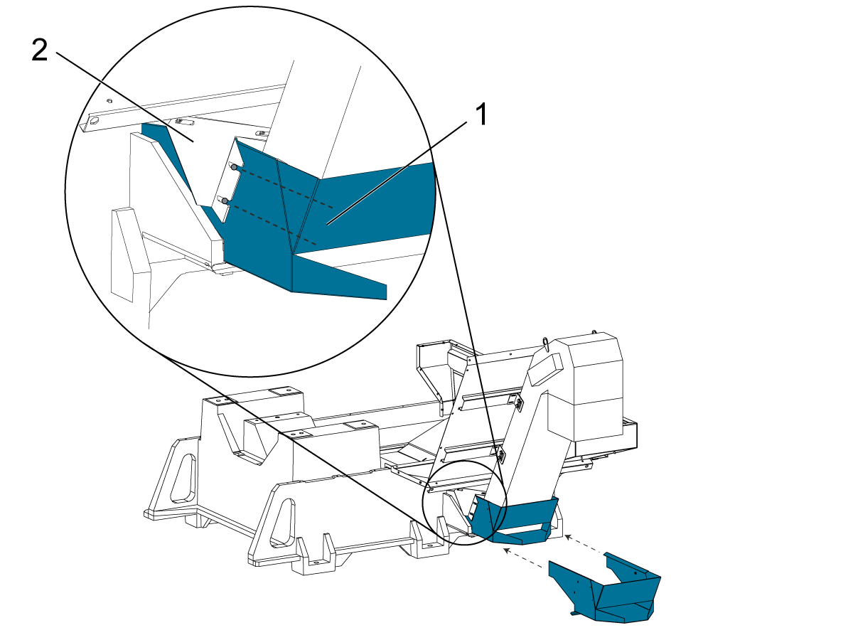

This procedure will show how to add the Chip Conveyor Drain Pan Spillway Extension on a UMC - 500/SS.
Important: It is crucial to select the right kit for the corresponding UMC - 500/SS built date.
This document applies to these following kits:
Machines built before 02/24/2022 will order the following kit:
  • 93-3921: CHIP EVAC KIT SHORT SPILL UMC-500
Machines built after 02/24/2022 will order the following kit:
  • 93-3928: CHIP EVAC KIT LONG SPILL UMC-500

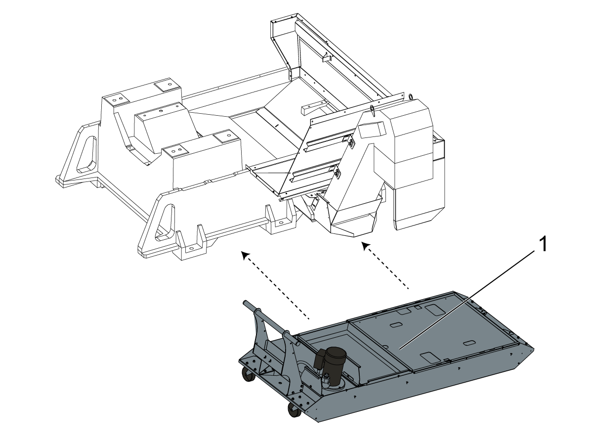

Note: Before starting the replacement, drain some coolant from the coolant tank to avoid spillage when the coolant tank is being moved.
Slide out the Coolant Tank [1]

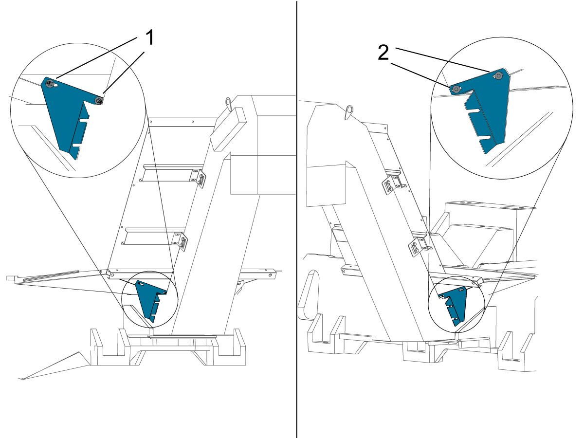

Install Left Adapter Bracket [1] and Right Adapter Bracket [2] using ¼ - 20 bolts to Chip Conveyor Funnel Enclosure.

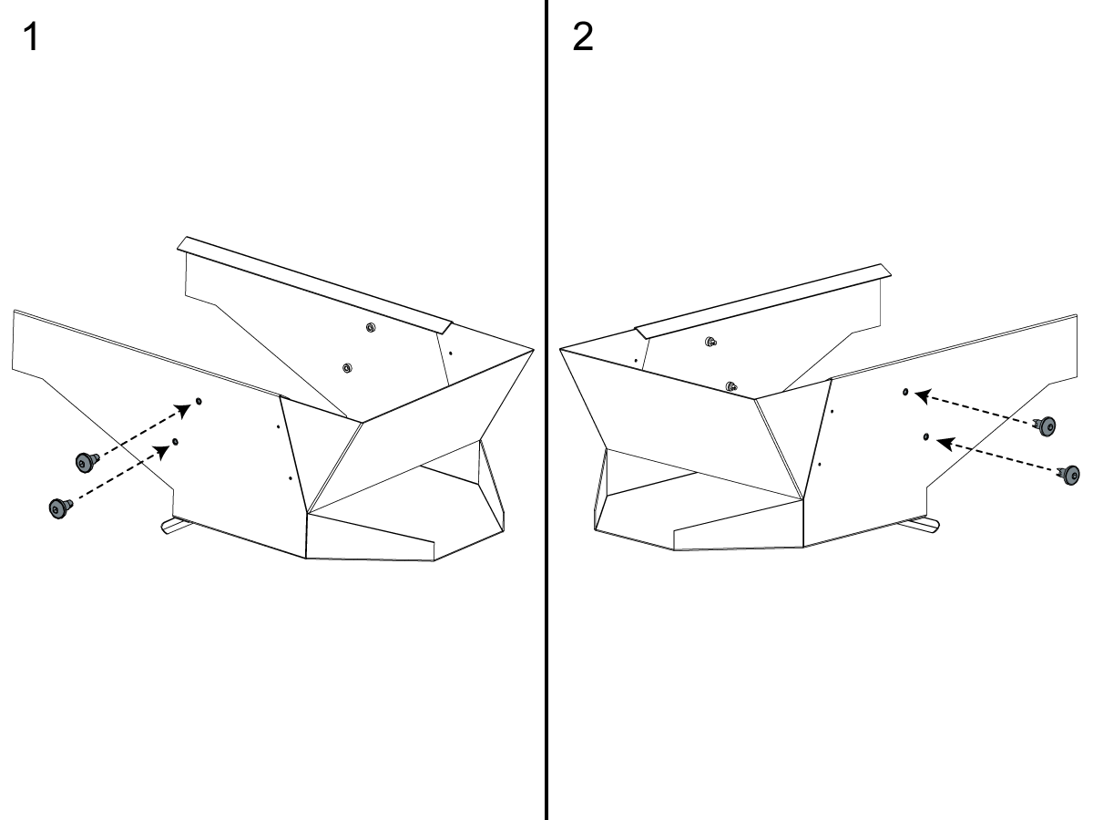

Screw in 1/4 - 20 bolts to Drain Pan Spillway in both left [1] and right [2] as shown in the image.
Slide Drain Pan Spillway [1] until it is up against the spillway such that the bolts added in step 3 are in the slots of the left and right Adapter Bracket [2].
Slide the Coolant Tank [1] in place.
Turn on the coolant and run the Chip Conveyor to check for any leaks.
