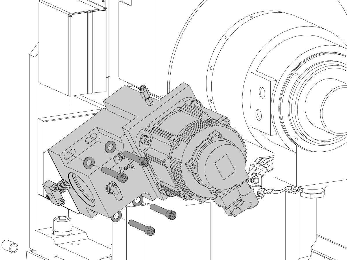

C-Axis Hydraulic Actuator Removal
PN: 93-2919A C-AXIS HYD ACTUATOR SVC KIT
Power down the machine and remove necessary sheetmetal to access the C-Axis Hydraulic Actuator.
Verify that the C-axis motor is disengaged and disconnect the air line, hydraulic line and servo motor cables.
Remove the hardware and C-Axis Hydraulic Actuator assembly.

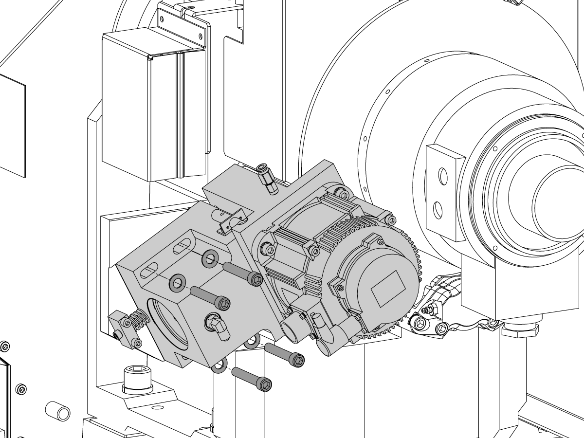

C-Axis Hydraulic Actuator Install
Install the C-Axis Hydraulic Actuator assembly and connect the air line, hydraulic line, and servo motor cables.
Reference the Haas Fastener Torque Specifications.
Perform the C-Axis Engagement Offset procedure.
Reinstall the sheet metal panels that were removed.
