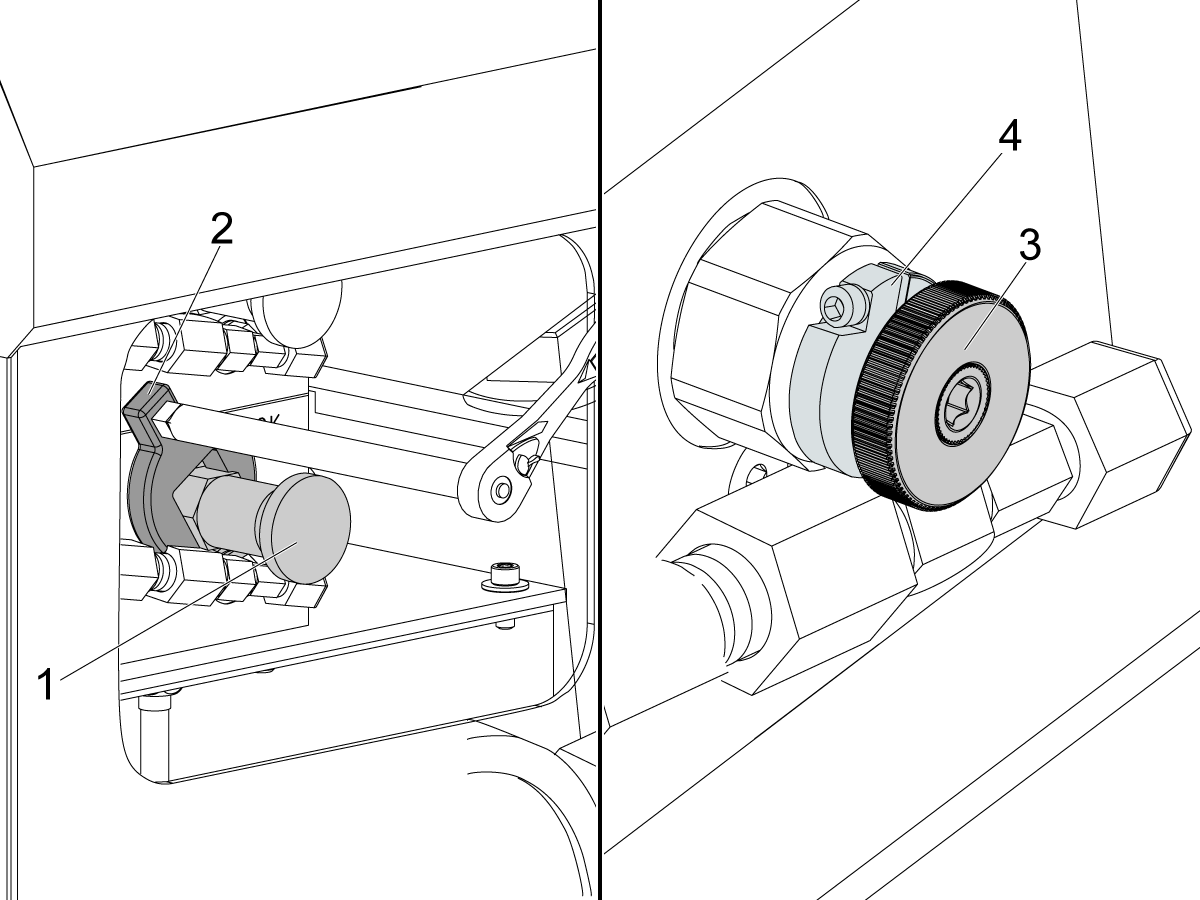

 Note: The illustrations show the replacement of the chuck valve. The tailstock valve replacement is the same.
Press [POWER OFF]. Set the main circuit breaker to the OFF position. Lock the main circuit breaker. Use an approved lock with an approved safety tag.
Remove the valve [1] from the valve block with a crow foot wrench [2]. Before you install the replacement valve, turn the main adjustment knob [3] on the adjustment valve counterclockwise until it stops.
Install the replacement adjustment valve with the crow foot wrench [2]. Leave the screw on the locking jam nut [4] loose.
Unlock and turn on the main circuit breaker. Press [POWER ON].
Release [EMERGENCY STOP]. Press [RESET] to start the Hydraulic Power Unit (HPU).
Refer to the link at the end of the document for the correct pressure. Do not exceed the correct pressure, or permanent damage to the chuck can occur. Slowly raise the pressure of the HPU to the correct maximum value: Turn the main adjustment knob [3] clockwise, check the pressure after each quarter turn. Repeat the process until the HPU is set to the correct pressure. The machine can generate a low pressure alarm until the correct pressure is set.
Turn the locking jam nut [4] clockwise by hand until it stops on the valve body. Rotate the valve and the locking jam nut [4] counterclockwise together until the screw on the locking jam nut [4] is accessible. Tighten the #4-40 thread screw on the locking jam nut [4] to 14 in-lb (1.6 Nm). Hold the locking jam nut [4] while you tighten the screw. Rotate the main adjustment knob [3] clockwise until the locking jam nut stops against the valve body. Make sure that the maximum pressure is correct. If the pressure is not correct, loosen the #4-40 thread screw and rotate the locking jam nut [4] to set the correct pressure.
