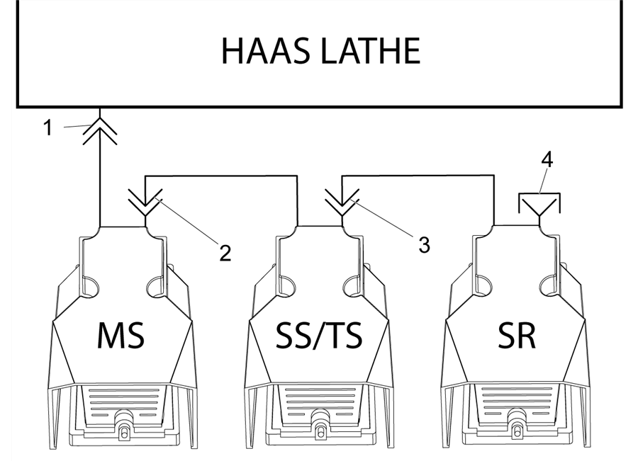

This procedure outlines how to install foot pedal's to a lathe. The amount of pedals for your machine will depend on the machine's configuration. There is one pedal for Main Spindle (MS), one pedal for Sub-spindle or Tailstock (SS/TS) and one pedal for the Steady Rest (SR).
Installation
The foot pedals are connected in series with the MS pedal connected to the machine's M12 connector [1], SS/TS pedal connected to the M12 connector on the MS pedal [2] and the SR pedal connected to the M12 connector on the SS/TS pedal [3].
Note: Make sure to cover unused M12 connector with the dust cap [4] to prevent contamination.
