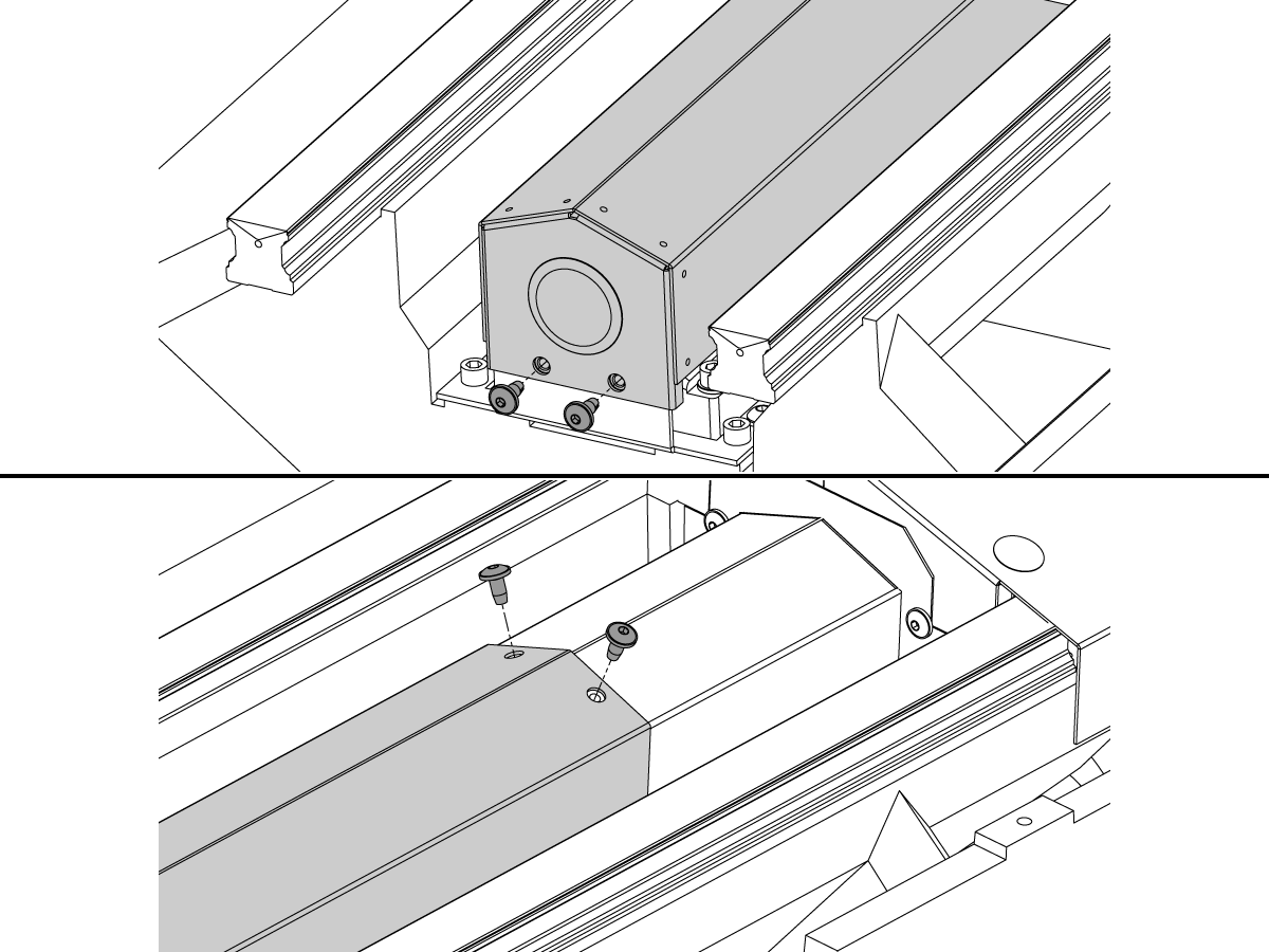

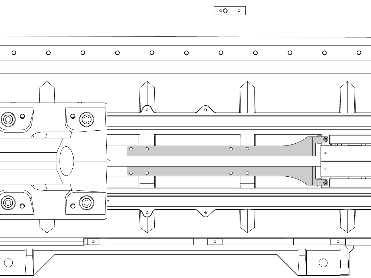

Remove the ACME screw cover.

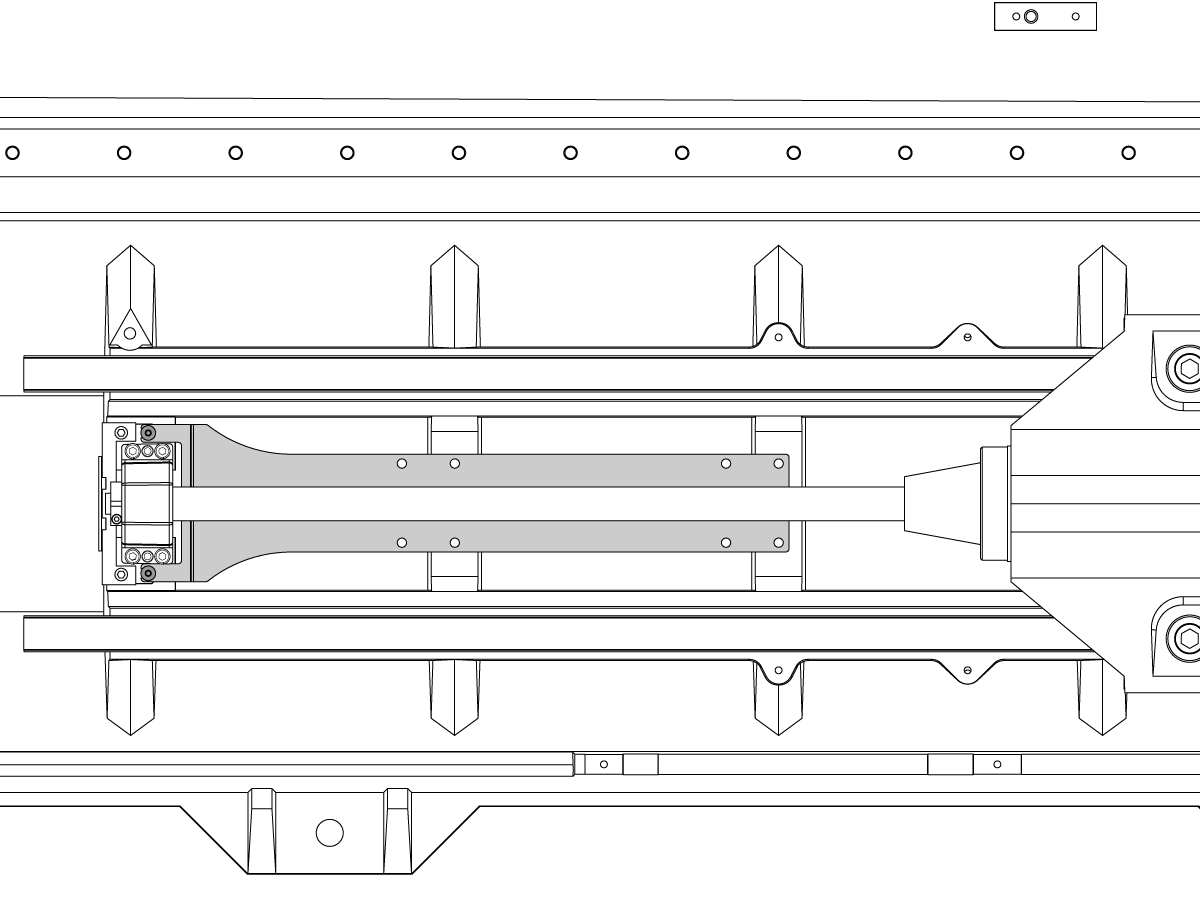

Install the front chip shield and secure with the included hardware.
Install the rear chip shield and align the center holes and secure with the included hardware.
Note: For illustration purposes the tailstock is removed. The tailstock does not need to be removed to install the chip shields.
If the base does not have tapped holes, use the shield holes as a template, drill and tap six 1/4"-20 thread holes at a depth of 0.600 inches into the ribs of the base casting.
Secure the chip shields to the base with the included hardware.
Reinstall the ACME screw cover.

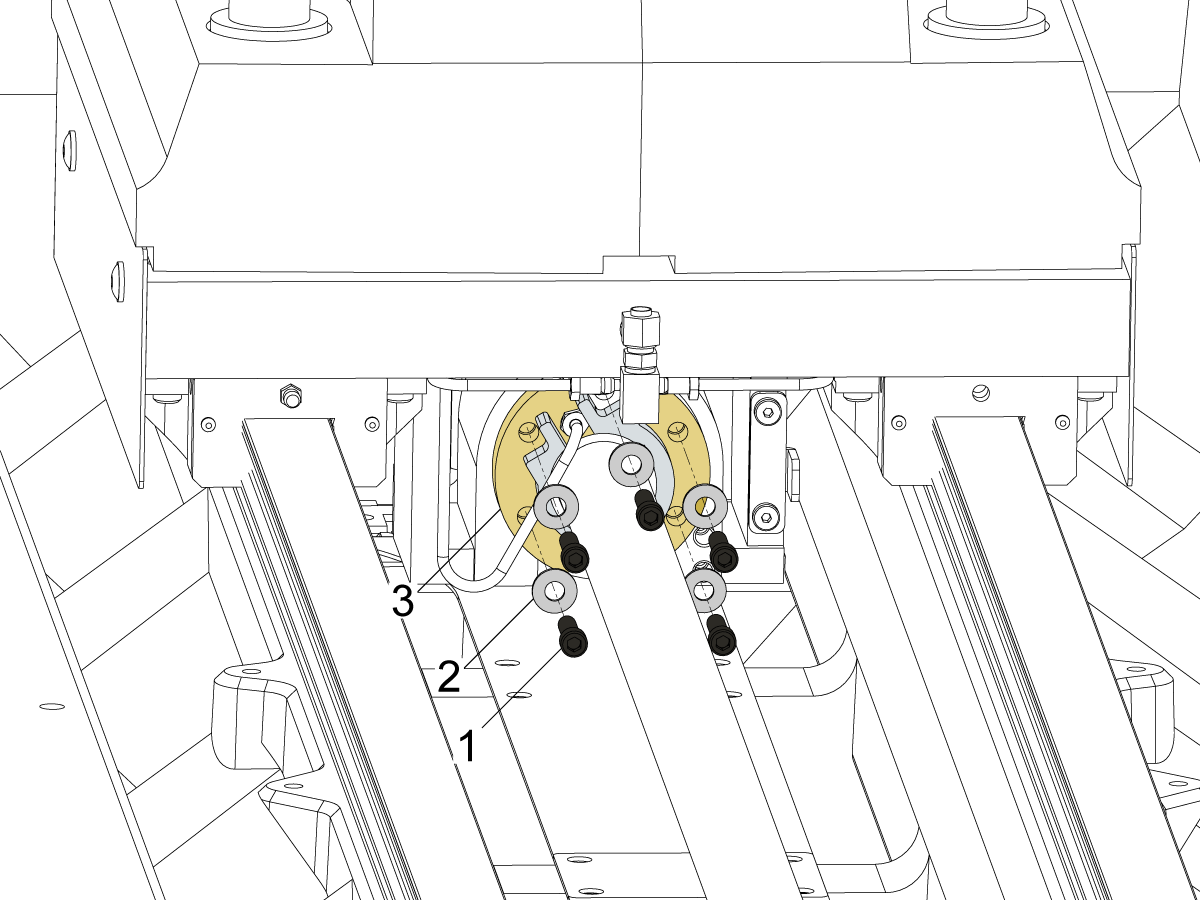

Unbolt the hardware [1] [2] connecting the ACME nut [3] to the nut housing.

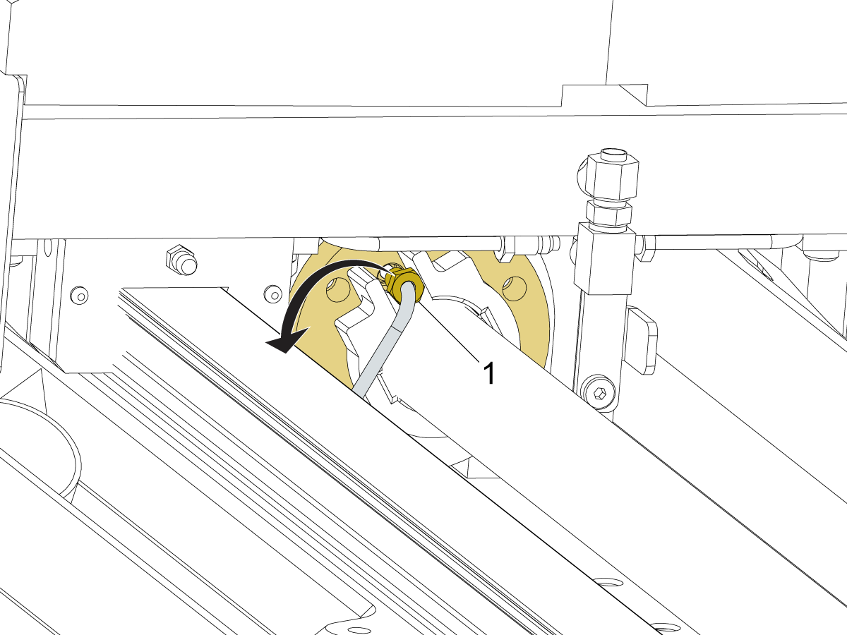

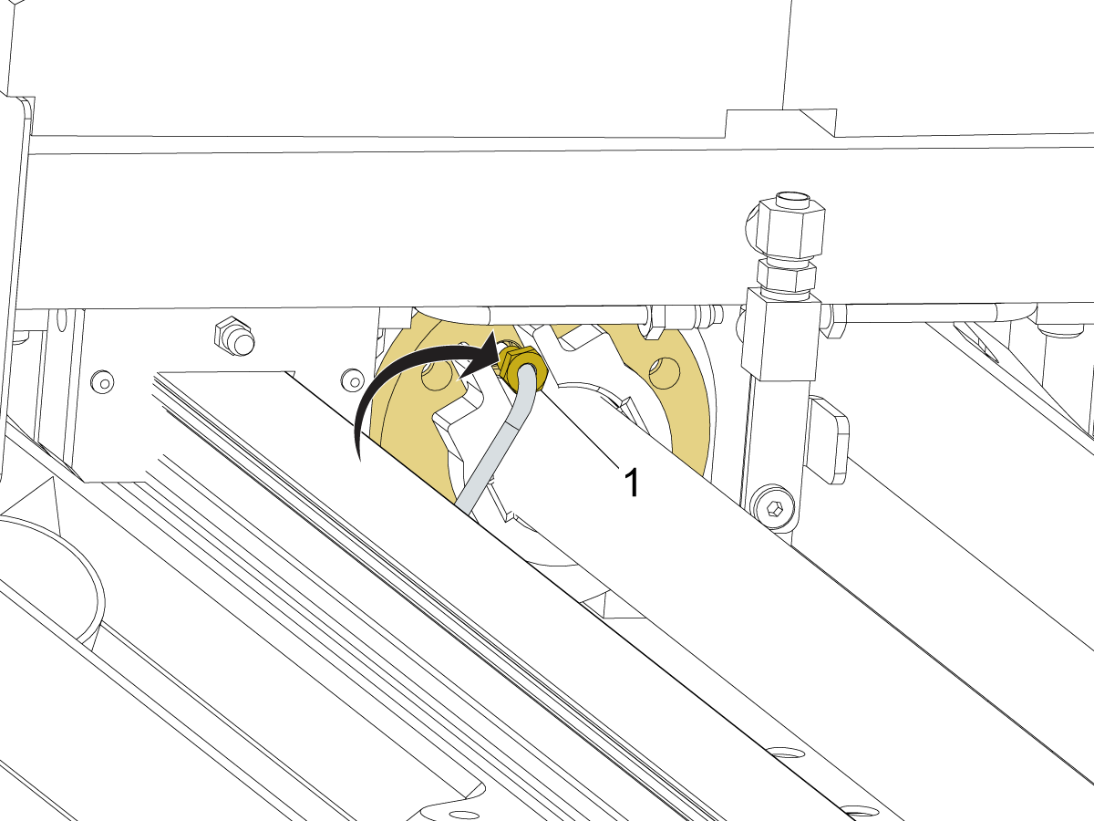

Loosen the lubrication line [1] to the ACME nut and carefully bend it out of the way so that the line is not damaged.
Note : Visually inspect the line to verify that it has not been kinked.

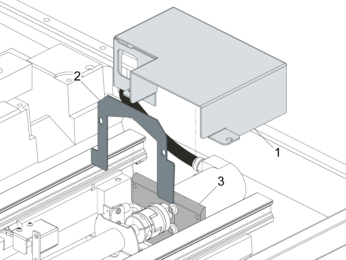

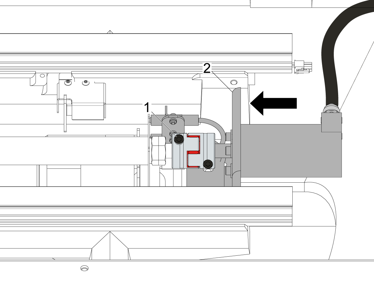

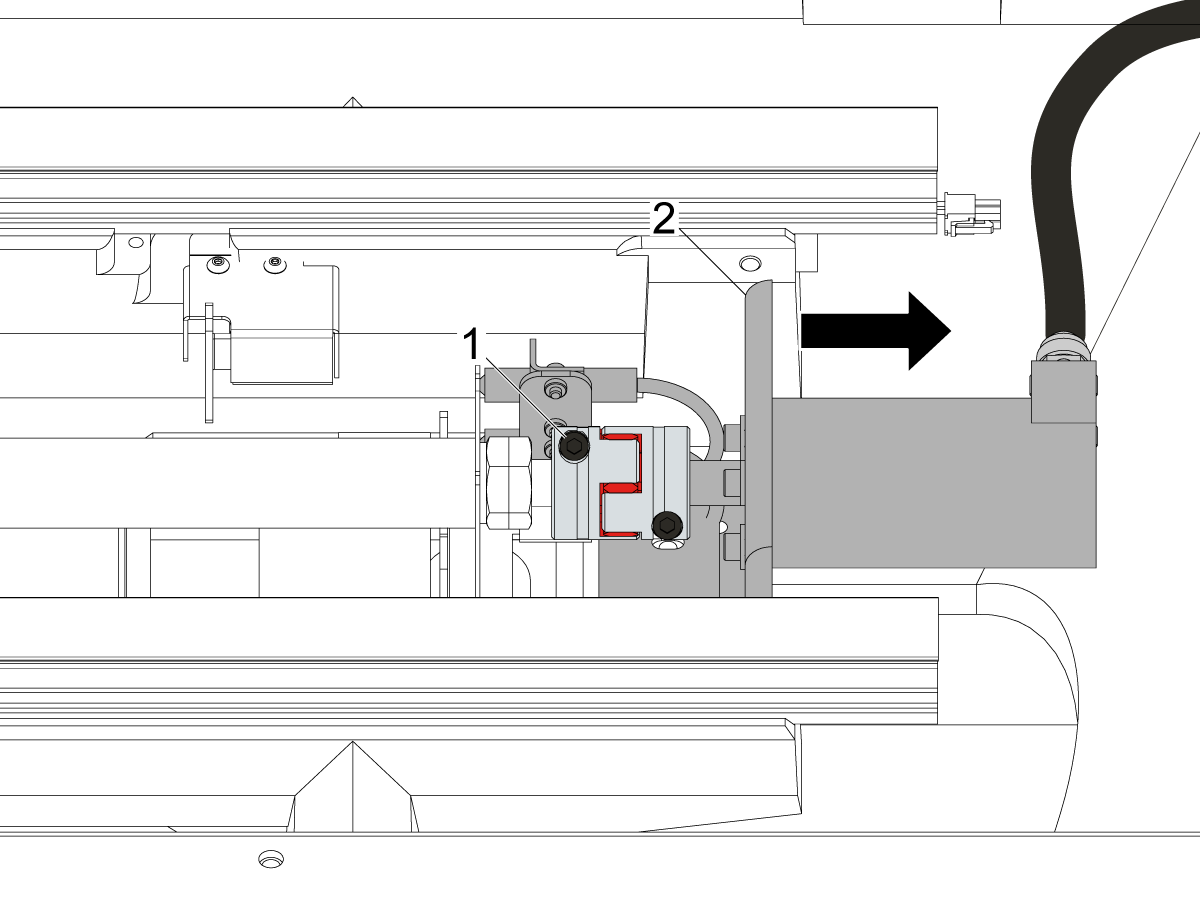

Remove the motor covers [1] [2] to gain access to the motor bracket [3].
Loosen the coupler bolt [1] on the ACME screw side and the unbolt the the motor bracket from the casting to slide the entire assembly [2] away.

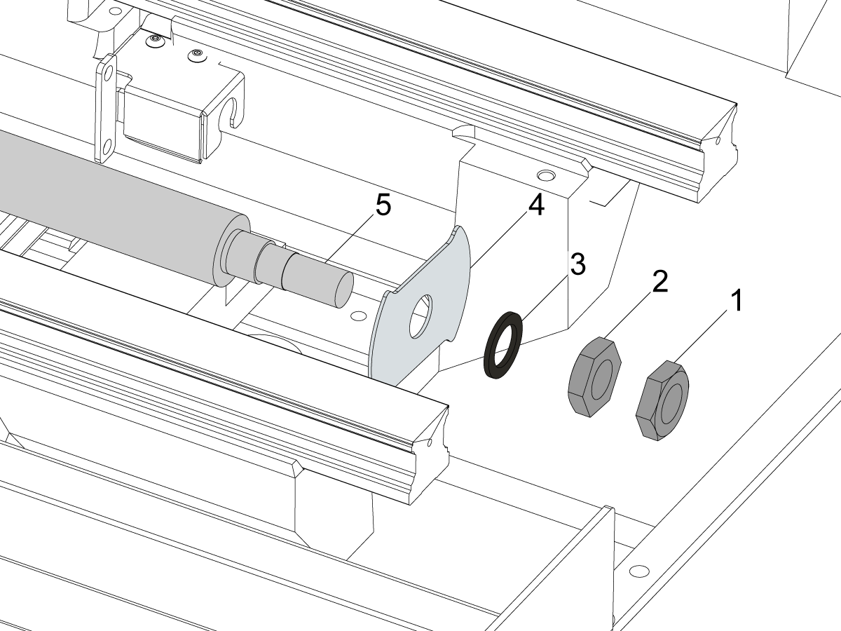

Remove proximity sensor flag [4] and hardware [3] [2] [1] from the ACME screw [5].
Note : Ensure the ACME screw remains supported using a block of wood.

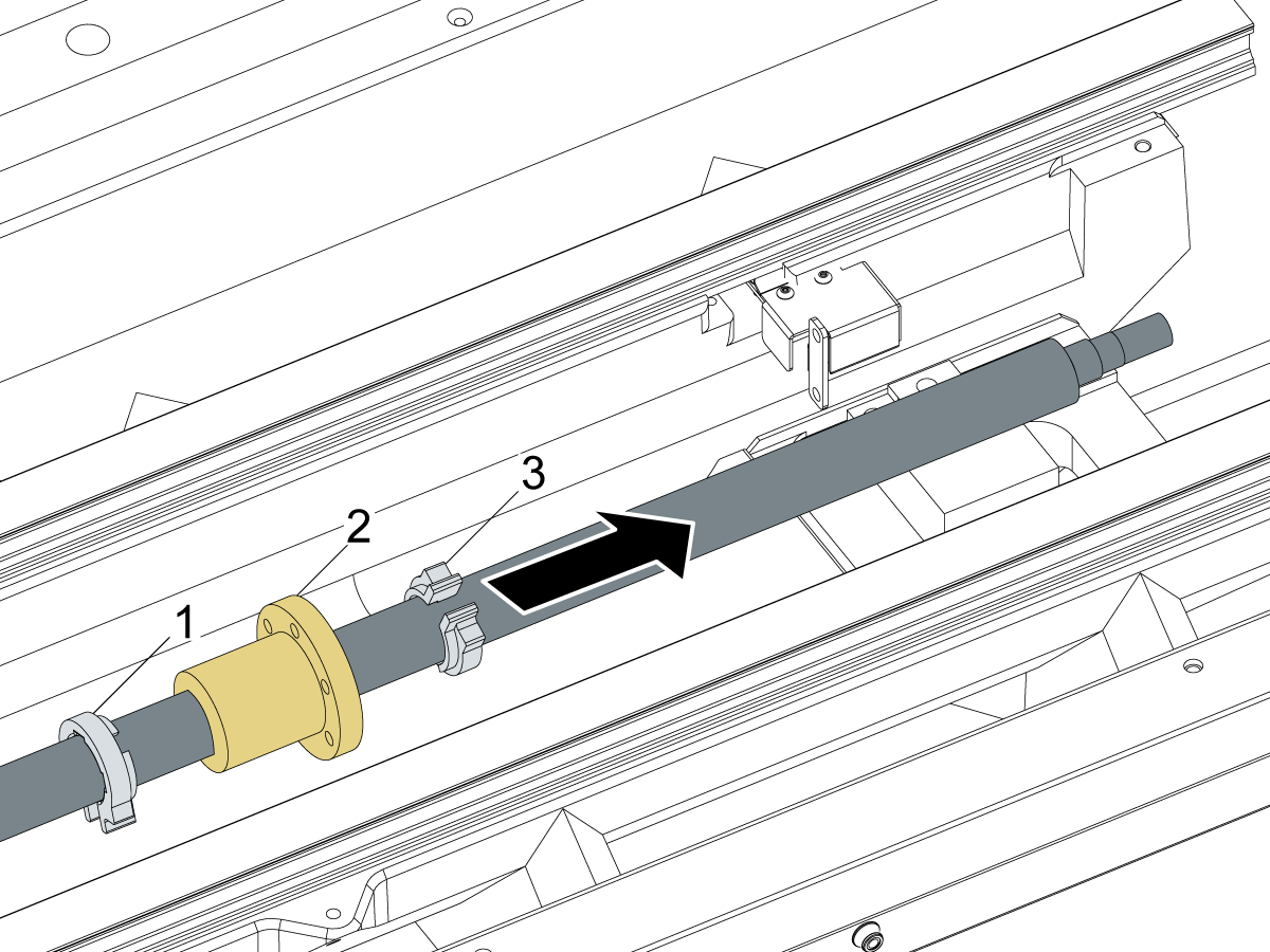

Remove the ACME nut [2] and wipers [1] [3].
Note : Remove the tailstock hard stop if it interferes with the ACME nut removal.
Important : Clean all the ACME screw threads and inspect for damage or excessive wear.
8
Important : Grease the ACME screw and the ACME nut  threads using a tacky lithium grease such as MOBILGREASE XHP 222.

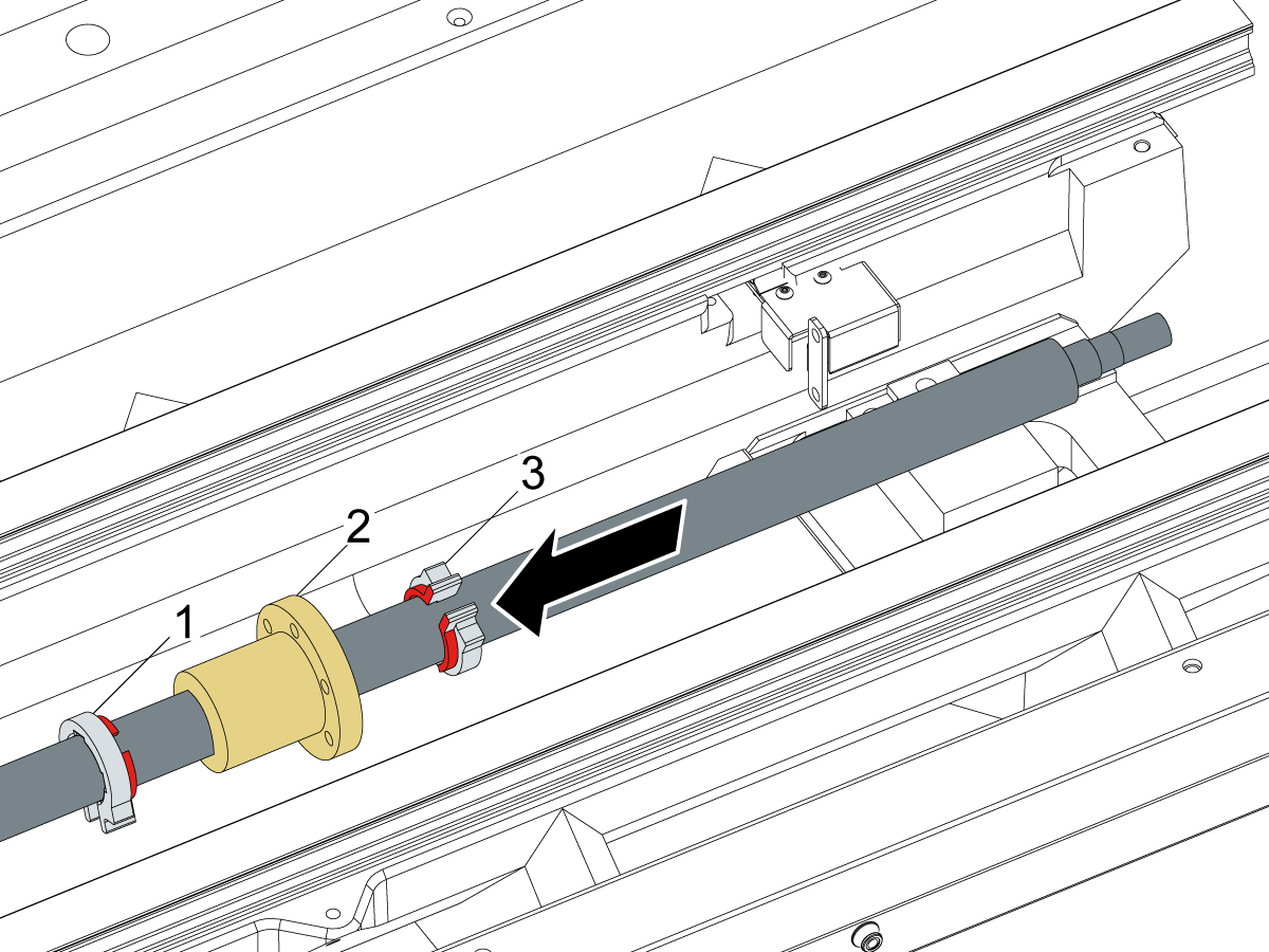

Install the each wiper [1] [3] so that the side with the shoulders face the ACME nut [2].
Ensure the support side wiper [1] against the ACME nut with the slot facing down.
Thread the wipers to the ACME nut and insure they are in the correct orientation.
Note : It is acceptable if the wipers are not touching the ACME nut.

Install the hydraulic motor assembly [2] and tighten the coupler pinch bolt [1].

Install the ACME nut [3] hardware [1] [2] and torque to specification.
Re-assemble the tailstock motor and ACME screw covers.
Note : Refer to Haas Torque Chart for all torque specifications.
