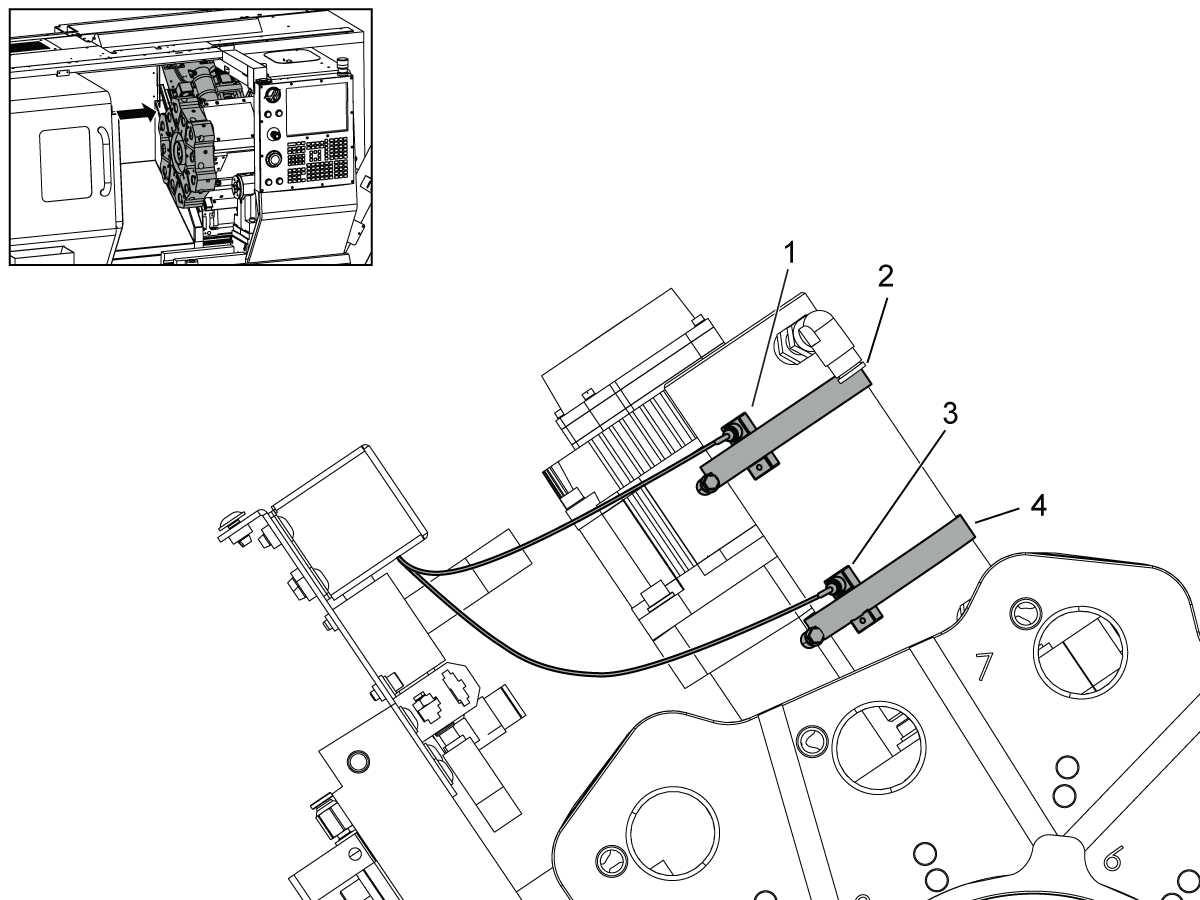

This procedure tells you how to adjust the turret locked and unlocked sensors. The procedure shows a ST-10 with software version L11.13A.
  • Turret locked sensor [1]
  • Clamp for the turret locked sensor [2]
  • Turret unlock sensor [3]
  • Clamp for the turret unlocked sensor [4]

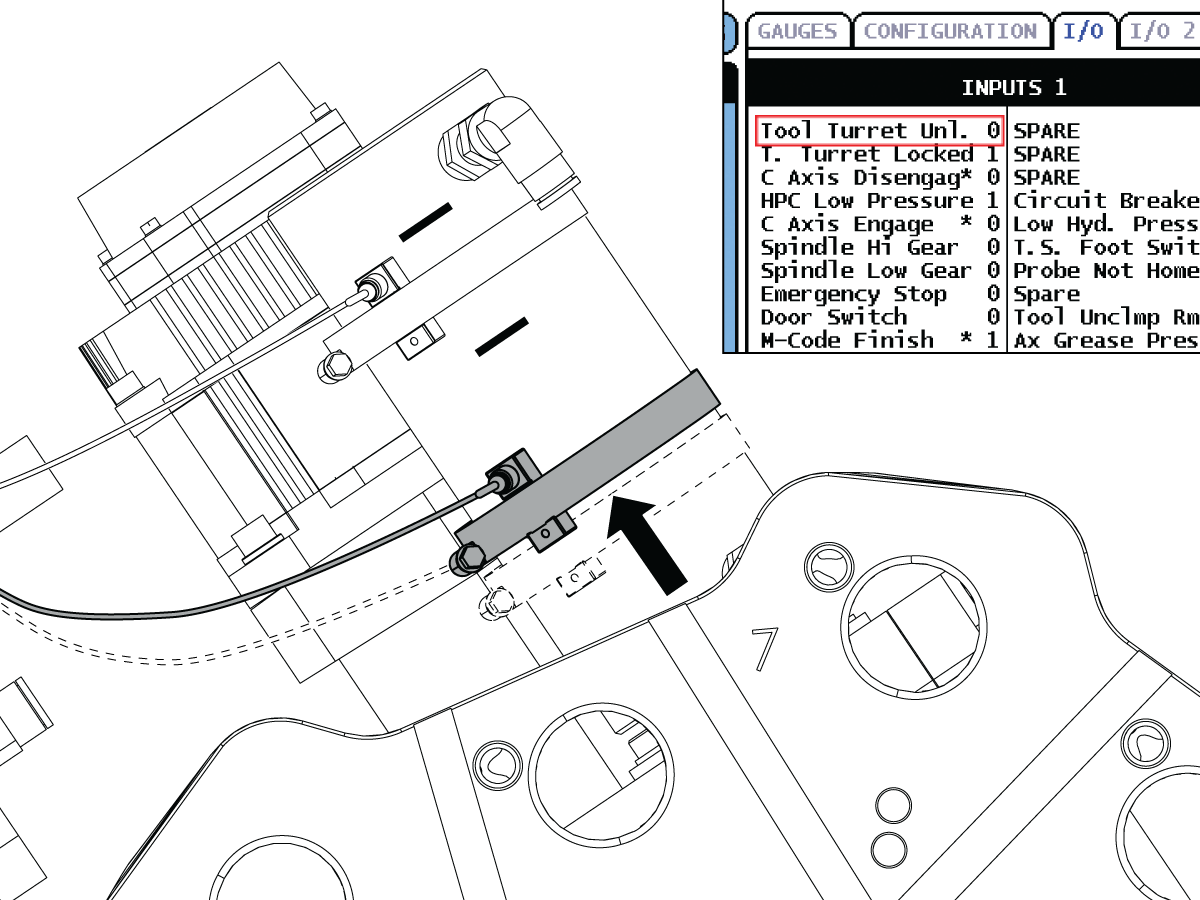

Do these steps. Monitor the PARAMETER DIAGNOSTIC screen at the same time:
  1. Loosen the lock sensor clamp. Move the lock sensor and clamp up until T. Turret Locked changes to 0.
  2. Slowly move the lock sensor and clamp up. Find the location where the value is as near as possible to 1, but the value is 0.
  3. Put a mark on the turret lock cylinder on the outside of the lock sensor clamp.
  4. Repeat Step 1. Repeat Step 2, but move the clamp down. Repeat Step 3.
  5. Move the lock sensor and clamp to the middle point between the two marks. Tighten the clamp.
Push [A], [ZERO RETURN], then [SINGLE]. Make sure the T. Turret Locked value is equal to 1 . Operate this program in MDI mode.
  1. Operate this code in MDI mode: M43 .
  2. Loosen the unlock sensor clamp.
  3. Move the unlock sensor and clamp up until Tool Turret Unl. changes to 0.
  4. Slowly move the unlock sensor and clamp up. Find the location where the value is as near as possible to 1, but the value is 0.
  5. Put a mark on the turret lock cylinder on the outside of the unlock sensor clamp.
  6. Repeat Step 3. Repeat Step 4, but move the clamp down. Repeat Step 5.
  7. Move the unlock sensor and clamp to the middle point between the two marks. Tighten the clamp.
Push [A], [ZERO RETURN], then [SINGLE]. Make sure T. Turret Locked is 1. Operate this program in MDI mode. This program makes sure the turret unlock sensor operates correctly:
