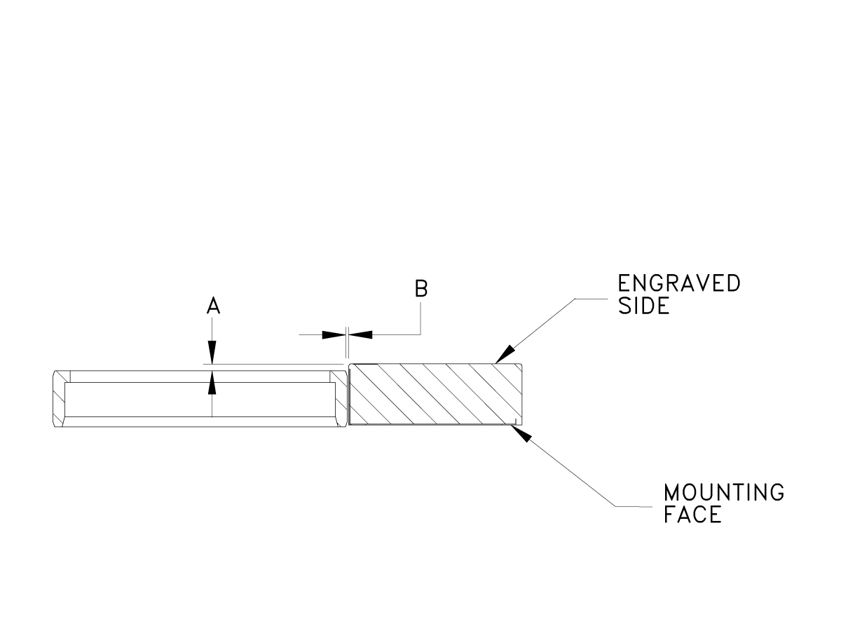

Mill Encoder Ring to Read Head Alignment
Generation 2 Alignment: Proper alignment of the read head to the encoder ring is critical.  Check that the axial alignment and running gap of the encoder ring are correct.
[A] 0.000 +/- 0.045
[B] 0.012 + 0.008 - 0.004
 Note: If the read head and encoder cannot be aligned, the alignment bracket may need to be replaced. See Replace Alignment Bracket below.
Note: For Generation 1 encoders, use the chart below.
Generation 1 Alignment: Proper alignment of the read head to the encoder ring is critical. The alignment will vary based on the brand of encoder.  Use the chart provided to make sure the encoder ring and read head are properly aligned.
VENDOR                               RLS                                    BAUMER
A                              0.020" +0.020 / -0.039                 0.0453" +/- 0.019
B                              0.0118" +0.0079 / -0.0039           0.0118" +/- 0.0039
C                                           0.362"                                     0.360"
Incorrect installation of the spindle may axially misalign the motor shaft.  Measure the distance from the top of the motor shaft to the top of the motor TSC mounting hole surfaces.  It should be 1.291 ± .005.
If the shaft is axially misaligned the spindle motor must be replaced.
If your machine uses 20-6639 MOUNT READ HEAD NCE 3" DT KTR [1], order part 20-6639A MOUNT READ HEAD NCE 3" DT KTR.
If your machine uses 20-6944A NCE READ HEAD MOUNT 40T INLINE [2], order part 20-6944B NCE READ HEAD MOUNT, 40T INLINE.
If your machine uses 20-7960A NCE READ HEAD MOUNT, DT 20K, ST [3], order part 20-7960B MOUNT READ HEAD NCE 2" GEN2 20K.
If your machine uses 20-6596A NCE READ HEAD MOUNT, 50T SPINDL [4], order part 20-6596B MOUNT READ HEAD NCE 3" GEN2 50T.
