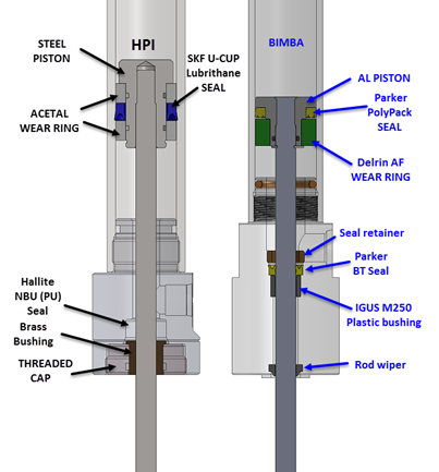

Bimba brand (grey) counterbalance cylinders may make a noise from the rod wiper. This is a normal noise from Bimba brand cylinders. They have a lower rod wiper to prevent contamination from entering the bottom of the cylinder. Do not replace Bimba counterbalance cylinders due to noise.
