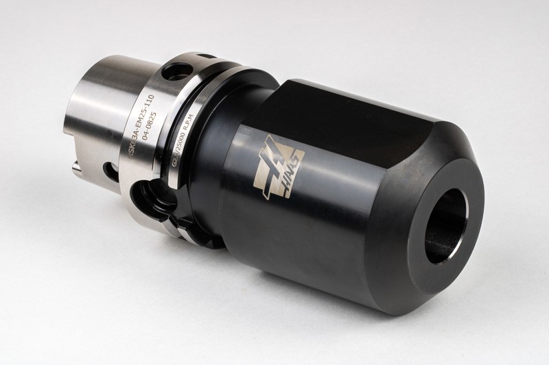

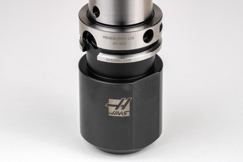

This HSK63A end mill holder has a 25mm bore diameter and a 110mm gage length. It uses the Weldon flat standard with side-lock clamping for secure clamping of cutting tools. It is through-tool coolant (TSC) capable.
Taper HSK63A
[ØD] Bore Diameter 25.0 mm
[ØBD] Body Diameter 65.0 mm
[ØBD2] Minimum Body Diameter 45.0 mm
[GL] Gage Length 110.0 mm
[BL] Body Length 84.0 mm
[ØD2] Shoulder Diameter 52.5 mm
[SH] Shoulder Height 16.0 mm
[TP1_L] Thread Location 24.0 mm
[TP2_L] Thread Location 25.0 mm
[TP1] Thread M18x2.0
[TP2] Thread M18x2.0
Concentricity 0.003 mm
Balanced to RPM 25,000
Bore Tolerance H5
Through Tool Coolant Yes
Spindle Drive Slots Yes
Weight 5.1 lbs \ 2.3 kg
