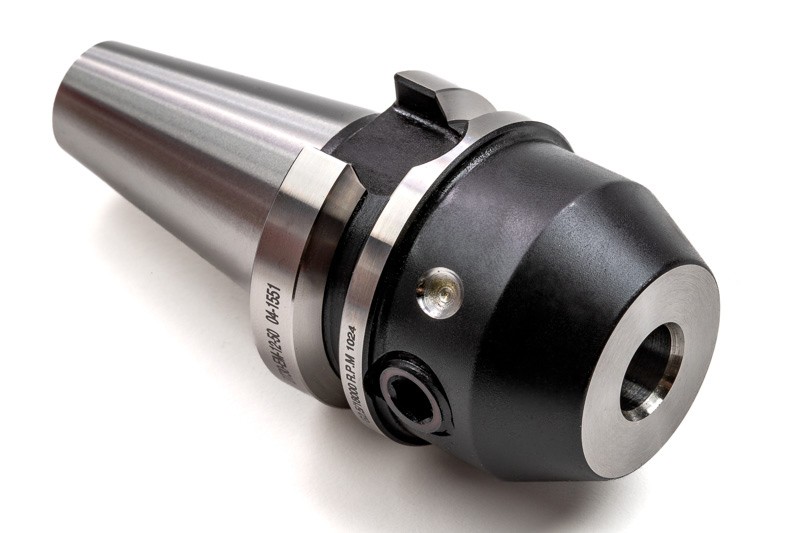

BT30 12mm End Mill Holder x 50mm Gage Length, TSC
Part #: 04-1551
BT30-EM-12-50
Price: 62.95 ( / unit)
This BT30 end mill holder has a 12.0 mm bore diameter and a 50mm gage length. It uses the Weldon flat standard with side-lock clamping for secure clamping of cutting tools. It is through-tool coolant (TSC) capable, with a M12x1.75 pull stud/retention knob thread.
Taper BT30
[ØD] Bore Diameter 12.0 mm
[ØBD] Body Diameter 42.0 mm
[ØBD2] Minimum Body Diameter 30.0 mm
[GL] Gage Length 50.0 mm
[BL] Body Length 28.0 mm
[TP1] Thread M12x1.75
Concentricity 0.003 mm
Balanced to RPM 18,000
Bore Tolerance H4
Retention Knob Thread Size M12X1.75
Through Tool Coolant Yes
Spindle Drive Slots Yes
Weight 1.4 lbs \ 0.7 kg
Country of Origin India
