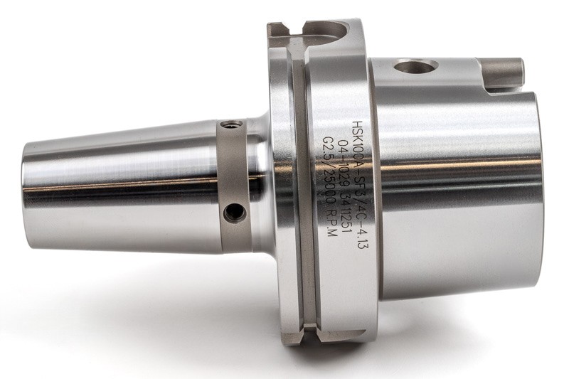

HSK100A 3/4" Shrink Fit Holder x 4.13" Gage Length, TSC
Part #: 04-1029
HSK100A-SF3/4C-4.13
Price: 398.95 ( / unit)
279.97
This high-quality Haas HSK100A shrink fit holder securely grips 3/4" shank tools, and has a 4.13" gage length. It offers very low runout (0.0001" TIR), very high grip force, and quick tool changeovers, when used with Haas shrink fit machines.

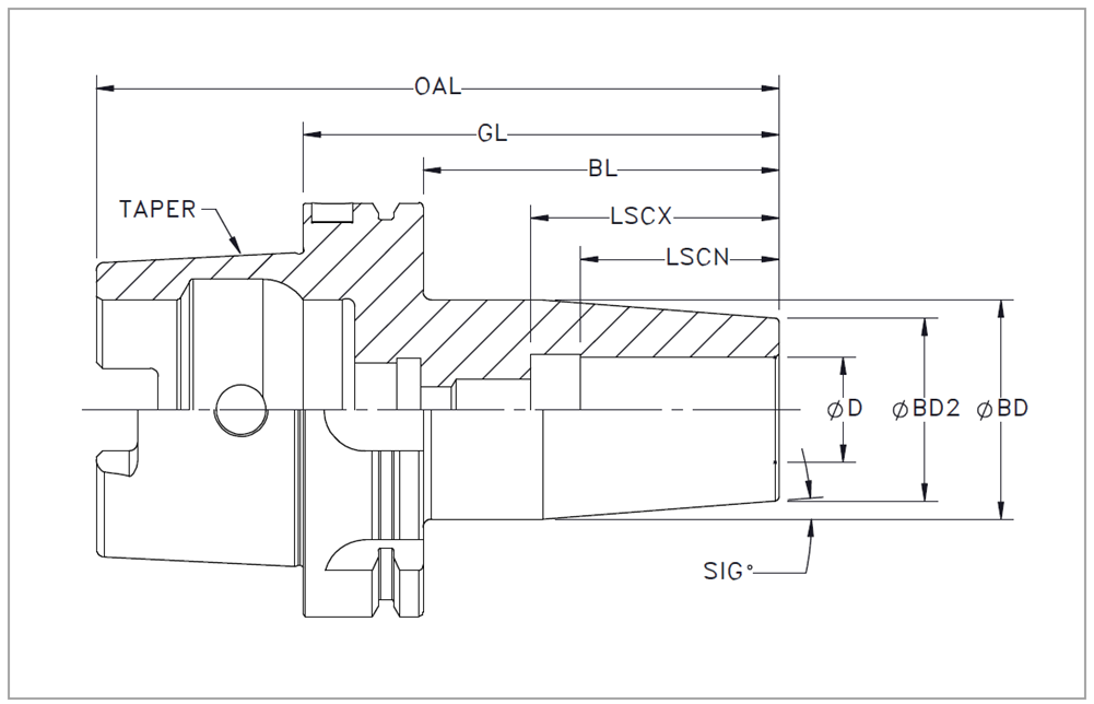

Taper HSK100A
[ØD] Bore Diameter 0.75 in \ 3/4"
[ØBD2] Minimum Body Diameter 1.299 in
[ØBD] Maximum Body Diameter 1.654 in
[GL] Gage Length 4.134 in
[BL] Body Length 2.992 in
[OAL] Overall Length 6.102 in
[LSCN] Minimum Clamping Length 1.654 in
[LSCX] Maximum Clamping Length 2.126 in
[SIG°] Angle 4.5 °
Concentricity 0.00012 in
Balanced to RPM 25,000
Through Tool Coolant Yes
Spindle Drive Slots Yes
Weight 6.0 lbs \ 2.7 kg
