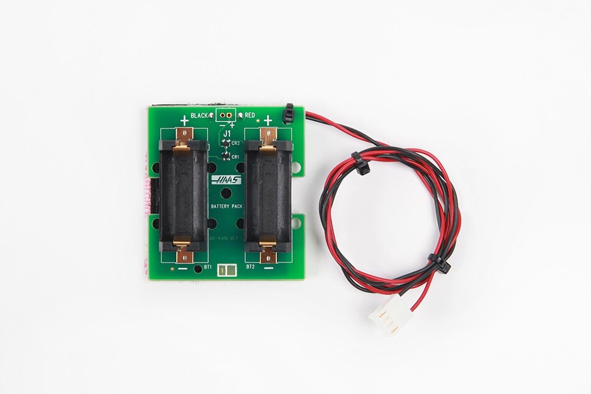

PCB, DUAL BATTERY REPLACEMENT KIT (BATTERIES NOT INCLUDED)
Part #: 93-32-4307
SERVICE KIT,BATTERY BOARD NO BATTERIES
Price: 104.95 ( / unit)
BATTERY UPGRADE
The Haas battery upgrade kit is a must for all Haas owners. The kit doubles your battery life, and provides an easy method for replacing the battery in the future that won’t lose your machine’s data, and doesn’t require a service tech.
This kit does not include the batteries.  You can obtain 3 Volt (BR or CR-2/3A style) batteries locally.
FEATURES
  • Plugs into the processor PCB
  • Simple, consolidated unit
  • Kit includes mounting for all generation control cabinets
BENEFITS
  • Doubles battery life
  • Maintains system memory
  • Simple to install, no soldering required
  • Two-battery system enables easy battery changes in the future (batteries not included)
  • Procedure Guide
