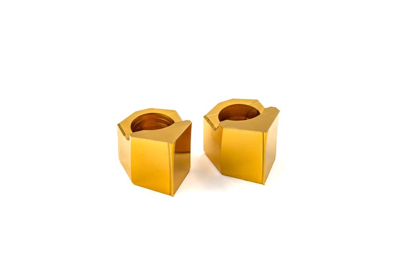

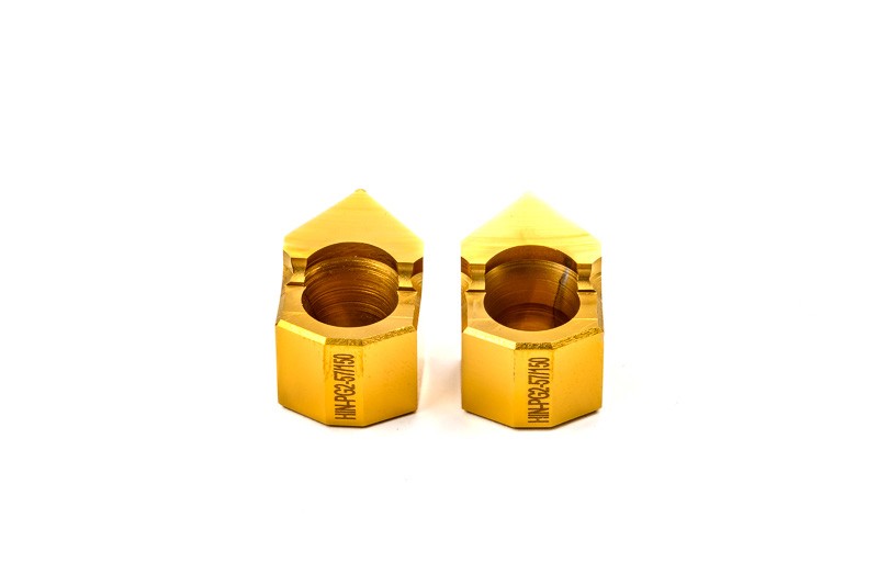

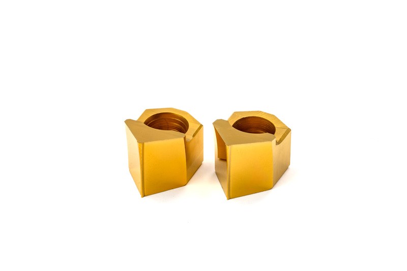

HIN-PG2, 57 - 150 Teeth GT® Synchronous Pulley Insert, 100 Tooth Profile, 2mm Pitch, Size 10, TiN Coated - Pack of 2
Part #: 02-1213
HIN-PG2-57/150
Price: $104.95 ( / unit)
Price: 2623.95 ( / unit)
Price: 780.95 ( / unit)
Price: 104.95 ( / unit)
Price: 472.95 ( / unit)
Price: 1101.95 ( / unit)

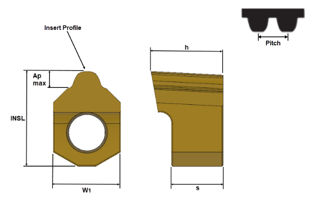

  • Technical Details
  • Speeds and Feeds
Insert Style Pulley
Insert Profile 100 Tooth
Insert Size 10
Belt Type PowerGrip®, GT® Synchronous
Part Diameter Range (Inch) 1.409 - 1.960 in (PG2-57/150)
Part Diameter Range (Metric) 35.78 - 49.78 mm (PG2-57/150)
Teeth Range (Min. - Max.) 57 - 150 (2mm Pitch)
Primary Workpiece Material K - Cast Iron, N - Aluminum, P - Steel
Secondary Workpiece Material H - Hardened Materials, M - Stainless Steel, S - High Temp Alloys
Chamfer Yes
Pitch 2
[INSL] Insert Length 0.728 in \ 18.5 mm
[W1] Insert Width 0.515 in \ 13.1 mm
[h] Insert Height 0.551 in \ 14.0 mm
[Ap] Max. Cutting Depth 0.03 in \ 0.762 mm
[S] Insert Thickness 0.394 in \ 10.0 mm
Country of Origin Italy
