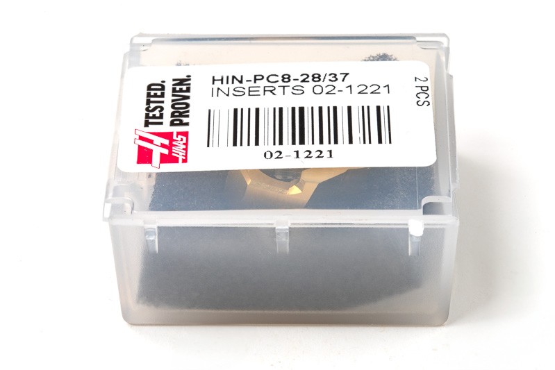

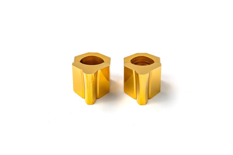

HIN-PC8, 28 - 37 Teeth GT® Synchronous Pulley Insert, 32 Tooth Profile, 8mm Pitch, Size 10, TiN Coated - Pack of 2
Part #: 02-1221
HIN-PC8-28/37
Price: $104.95 ( / unit)
Price: 2623.95 ( / unit)
Price: 780.95 ( / unit)
Price: 104.95 ( / unit)
Price: 472.95 ( / unit)
Price: 1101.95 ( / unit)
  • Technical Details
  • Speeds and Feeds
Insert Style Pulley
Insert Profile 32 Tooth
Insert Size 10
Belt Type Poly Chain®, GT® Synchronous
Part Diameter Range (Inch) 2.744 - 3.646 in (PC8-28/37)
Part Diameter Range (Metric) 69.70 - 92.62 mm (PC8-28/37)
Teeth Range (Min. - Max.) 28 - 37 (8mm Pitch)
Primary Workpiece Material N - Aluminum, P - Steel, K - Cast Iron
Secondary Workpiece Material S - High Temp Alloys, M - Stainless Steel, H - Hardened Materials
Chamfer Yes
Pitch 8
[INSL] Insert Length 0.728 in \ 18.5 mm
[W1] Insert Width 0.515 in \ 13.1 mm
[h] Insert Height 0.551 in \ 14.0 mm
[Ap] Max. Cutting Depth 0.134 in \ 3.4 mm
[S] Insert Thickness 0.394 in \ 10.0 mm
Country of Origin Italy
