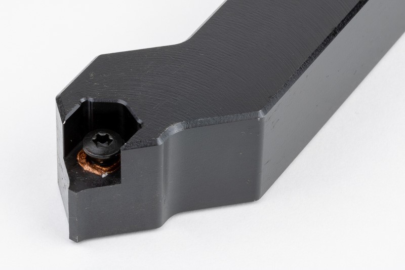

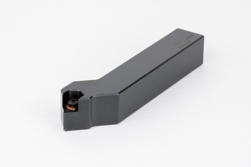

HUTE-25-DX, 25mm External (OD) Multi-Form Broaching Tool, 150mm Overall Length, Right-Hand, Insert Size 10
Part #: 01-0495
HUTE-25-DX
Price: 215.95 ( / unit)
Price: 3998.95 ( / unit)
Price: 1190.95 ( / unit)
Price: 159.95 ( / unit)
Price: 719.95 ( / unit)
Price: 1679.95 ( / unit)
151.97
2999.97
892.97
119.97
539.97
1259.97
  • Technical Details
Tool Orientation External
Hand of Tool Right
Insert Style Pulley, Keyway
Insert Size 10
[B] Shank Width 0.9843 in \ 25.0 mm
[L2] Length 4.33 in \ 110.0 mm
[OAL] Overall Length 5.91 in \ 150.0 mm
[F] Dimension 1.476 in \ 37.5 mm
[S] Center to Insert Dimension 0.984 in \ 25.0 mm
Country of Origin Italy
Weight 1.6 lbs \ 0.7 kg
