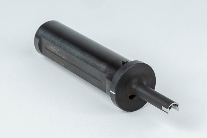

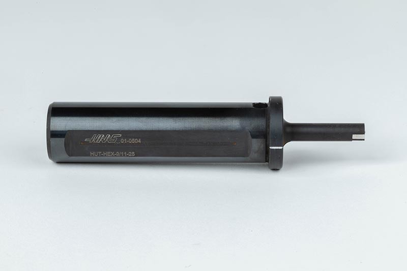

  • Technical Details
Tool Orientation Internal
Hand of Tool Neutral
Insert Style Hex
Insert Size 9/11
[ØD] Min. Machining Diameter 0.354 in \ 9.0 mm
[ØDMM] Shank Diameter 0.9843 in \ 25.0 mm
[Ød3] Diameter 1.181 in \ 30.0 mm
[Ød2] Diameter 0.315 in \ 8.0 mm
[LS] Shank Length 3.54 in \ 90.0 mm
[LOC] Length Of Cut 1.18 in \ 30.0 mm
[OAL] Overall Length 5.08 in \ 129.0 mm
[S] Center to Insert Dimension 0.117 in \ 4.5 mm
Through Tool Coolant Yes
Country of Origin Italy
Weight 0.9 lbs \ 0.4 kg
