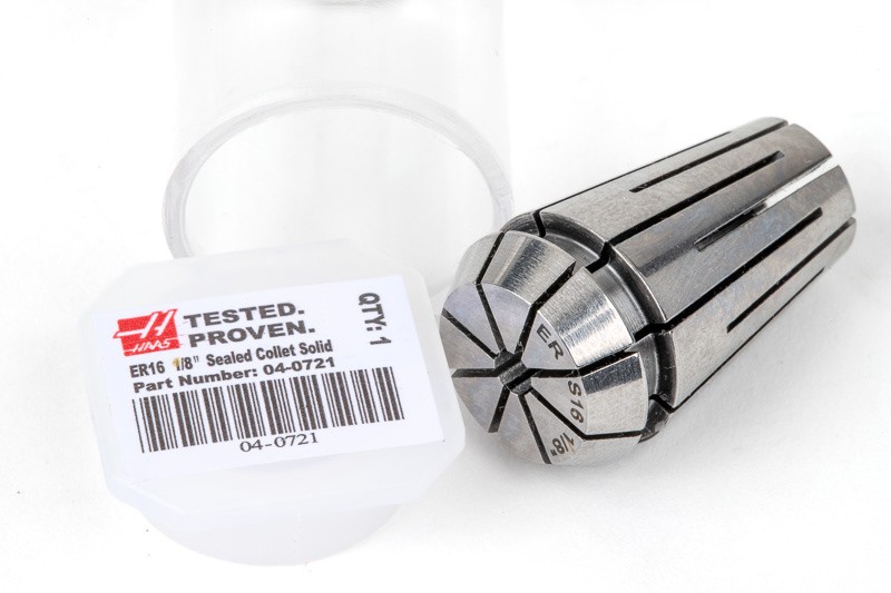

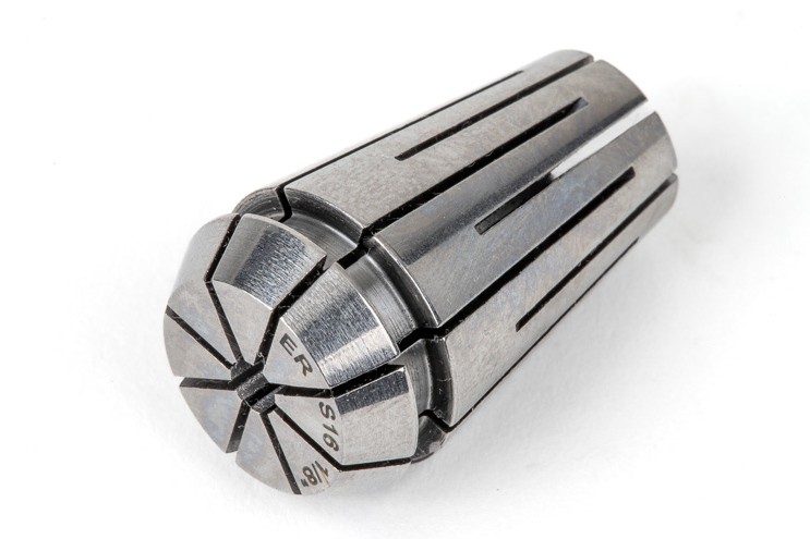

ER16 1/8" Straight-Bore Sealed Collet
Part #: 04-0721
ER16-1/8" SEALED COLLET
Price: 18.95 ( / unit)
This 0.125 in \ 1/8" ER16 straight-bore sealed collet for 0.125 in \ 1/8" round shank tools ensures that 100% of through-tool coolant (TSC) gets to the tip of the cutting tool. It has a 0.0004" TIR, and is defined by collet class 1, per DIN ISO 15488. This collet has no clamping range; the tool shank must be the exact diameter of the collet bore.
Collet Series ER-16
Collet Class Class 1
Type Straight Bore Sealed
[ØD] Bore Diameter 0.125 in \ 1/8"
[MIN] Minimum Length 0.925 in
Total Indicator Runout (TIR) 0.0004 in
