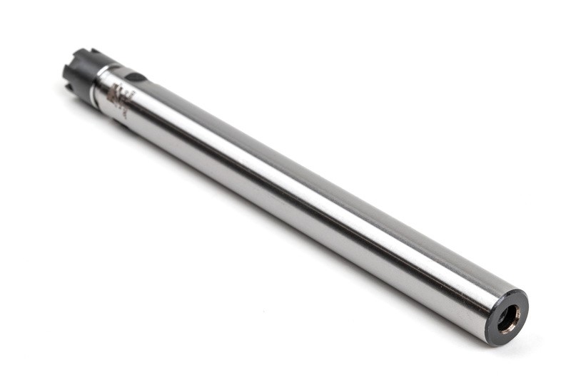

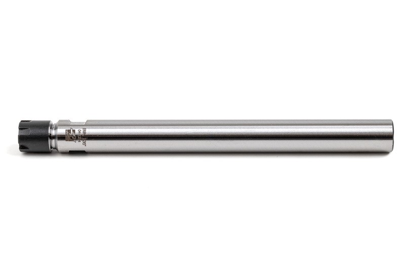

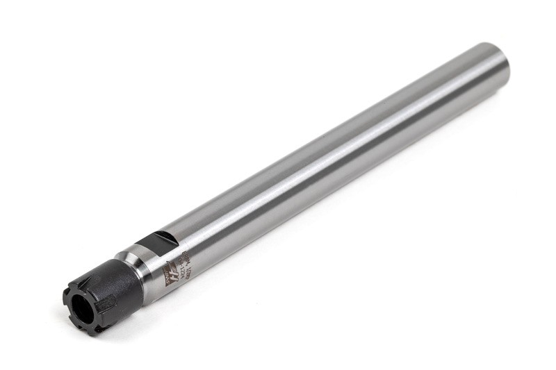

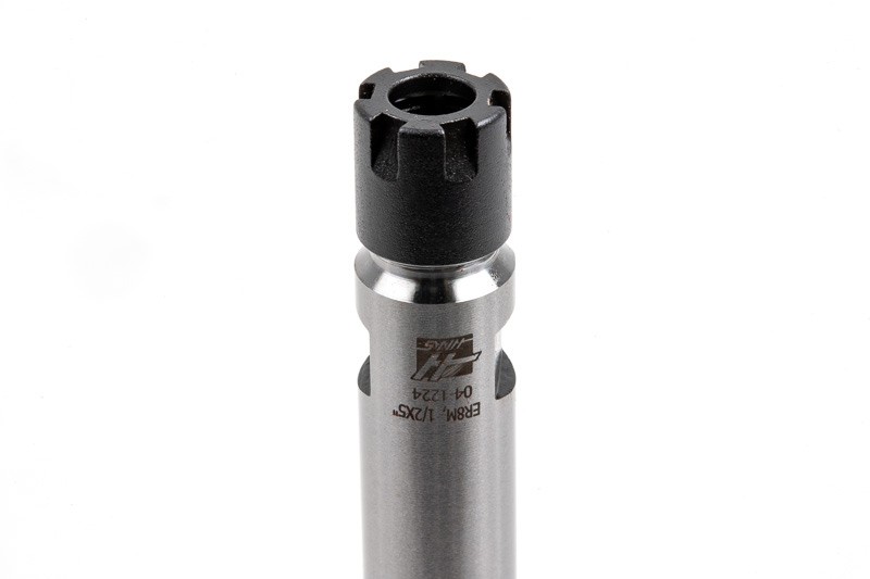

ER8M 1/2" Straight Shank Extended Collet Chuck x 5" Shank Length, TSC
Part #: 04-1224
COLLET EXTENSION, ER8M, 1/2x5"
Price: 57.95 ( / unit)
This straight shank ER8M collet extension accepts a variety of ER8M collet styles, and has a 0.5 in \ 1/2" shank, with a 5" shank length. It is primarily used as an extended-length milling collet, by clamping it into the appropriate end mill holder. The double-taper collet design provides high clamping force for round, smooth shank tools, and offers a wide gripping range with excellent TIR and balance.
Collet Series ER-8
[ØBD] Body Diameter 0.472 in
[ØDMM] Shank Diameter 0.5 in \ 1/2"
[LS] Shank Length 5.0 in
[OAL] Overall Length 5.673 in
[FS] Flat Size 0.394 in
[TP1] Thread M5x0.8
Concentricity 0.0004”
Through Tool Coolant Yes
Weight 0.3 lbs \ 0.2 kg
