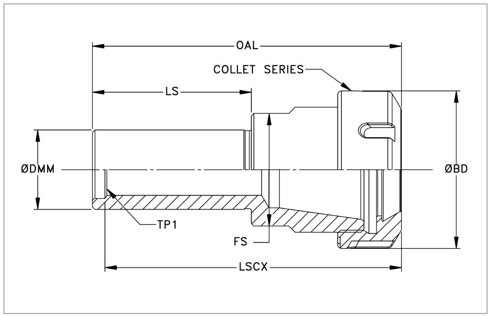

ER40 1-1/4" Straight Shank Collet Chuck, TSC
Part #: 04-1377
ST SHANK COLLET CHUCK 1-1/4" x ER40
Price: 69.95 ( / unit)
This straight shank ER40 collet chuck accepts a variety of ER40 collet styles, and has a 1.25 in \ 1-1/4" shank. The precision cylindrical shank requires a milled flat to mount into any internal (ID) turning holder with the appropriate bore size and set-screw clamping. The double-taper collet design provides high clamping force for round, smooth shank tools, and offers a wide gripping range with excellent TIR and balance. The collet chuck is through-tool coolant (TSC) capable, and also may be used as an extended-length milling collet, by clamping it into the appropriate end mill holder.
Collet Series ER-40
[ØBD] Body Diameter 2.48 in
[ØDMM] Shank Diameter 1.25 in \ 1-1/4"
[LS] Shank Length 2.5 in
[LSCX] Maximum Clamping Length 4.665 in
[OAL] Overall Length 4.862 in
[FS] Flat Size 1.772 in
[TP1] Thread M22.5x1.5
Concentricity 0.0001"
Through Tool Coolant Yes
Weight 1.8 lbs \ 0.8 kg
