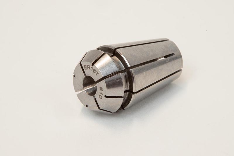

ER16 #10 Tap Collet, 0.194" Bore Diameter x 0.152" Square
Part #: 04-0105
ER16-#10 TAP COLLET 0.194" X 0.152"
Customer Rating:
Price: 23.95 ( / unit)
13.97
This ER16 tap collet for #10 taps has a 0.194" bore diameter and a 0.152" built-in square drive to securely grip flat-sided tap shanks, providing the extra torque required for tapping. It has a 0.0006" TIR, and is defined by collet class 2, per DIN ISO 15488. This collet has no clamping range; the tool shank must be the exact diameter of the collet bore.
Collet Series ER-16
Collet Class Class 2
Type Tap Collet
Tap Size #10
[ØD] Bore Diameter 0.194 in
[LSC] Clamping Length 0.591 in
[SS] Square Size 0.152 in
Total Indicator Runout (TIR) 0.0006 in
