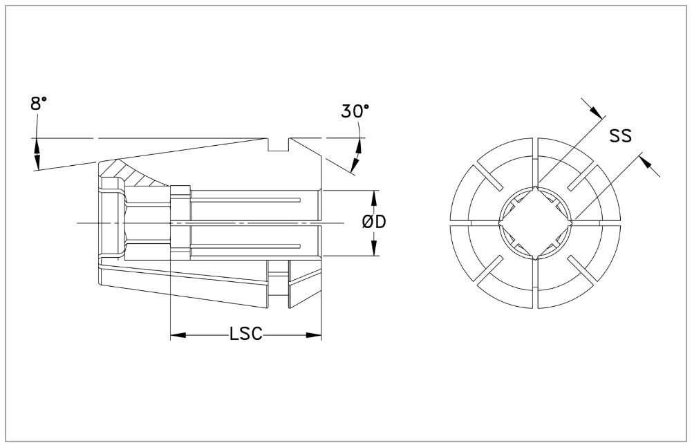

This ER32 tap collet for #8 taps has a 0.168" bore diameter and a 0.131" built-in square drive to securely grip flat-sided tap shanks, providing the extra torque required for tapping. It has a 0.0006" TIR, and is defined by collet class 2, per DIN ISO 15488. This collet has no clamping range; the tool shank must be the exact diameter of the collet bore.
Collet Series ER-32
Collet Class Class 2
Type Tap Collet
Tap Size #8
[ØD] Bore Diameter 0.168 in
[LSC] Clamping Length 0.709 in
[SS] Square Size 0.131 in
Total Indicator Runout (TIR) 0.0006 in
Weight 0.4 lbs \ 0.2 kg
