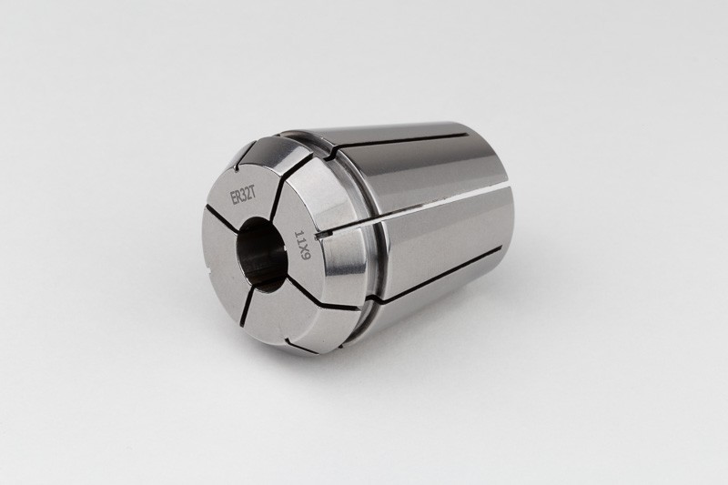

This ER32 tap collet for M14 taps has a 11mm bore diameter and a 9mm built-in square drive to securely grip flat-sided tap shanks, providing the extra torque required for tapping. It has a 0.015mm TIR, and is defined by collet class 1, per DIN ISO 15488. This collet has no clamping range; the tool shank must be the exact diameter of the collet bore.
Collet Series ER-32
Collet Class Class 1
Type Tap Collet
Tap Size M14
[ØD] Bore Diameter 11.0 mm
[LSC] Clamping Length 25.0 mm
[SS] Square Size 9.0 mm
Total Indicator Runout (TIR) 0.015 mm
Weight 0.4 lbs \ 0.2 kg
