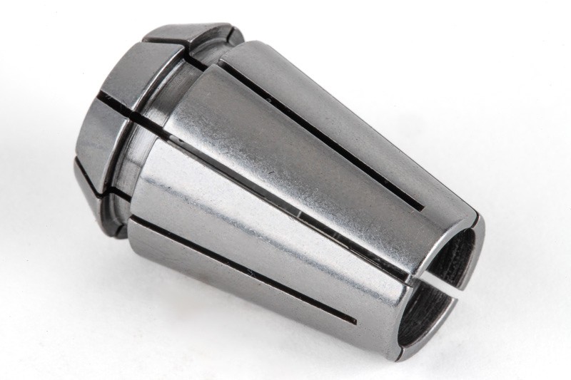

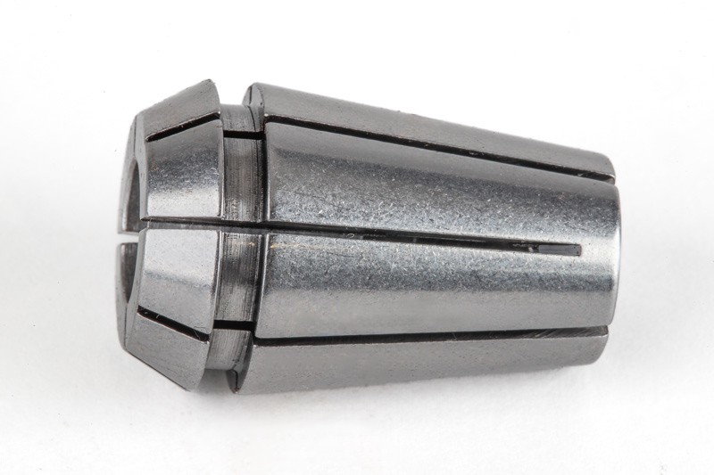

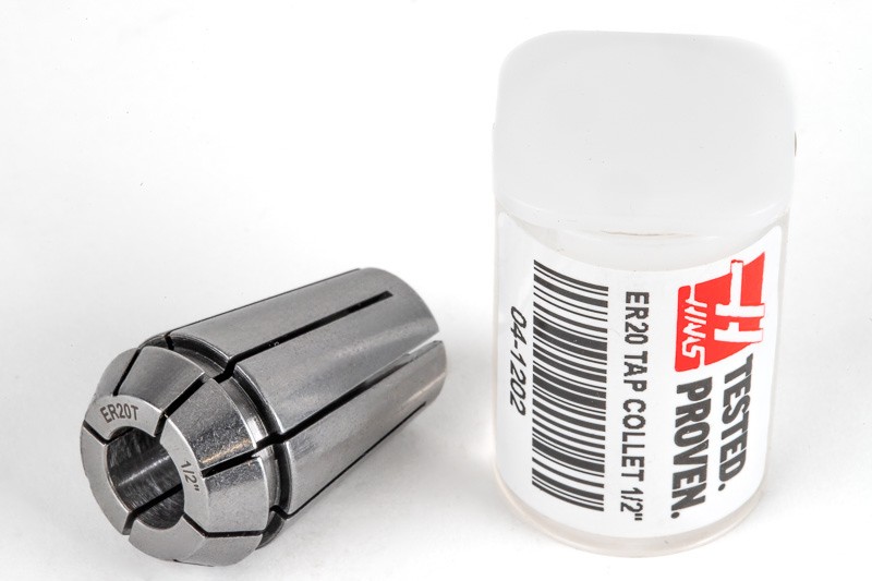

ER20 1/2" Tap Collet, 0.367" Bore Diameter x 0.275" Square
Part #: 04-1202
ER20-1/2" TAP COLLET 0.367" X 0.275"
Price: 23.95 ( / unit)
15.97
This ER20 tap collet for 1/2" taps has a 0.367" bore diameter and a 0.275" built-in square drive to securely grip flat-sided tap shanks, providing the extra torque required for tapping. It has a 0.0006" TIR, and is defined by collet class 2, per DIN ISO 15488. This collet has no clamping range; the tool shank must be the exact diameter of the collet bore.
Collet Series ER-20
Collet Class Class 2
Type Tap Collet
Tap Size 1/2"
[ØD] Bore Diameter 0.367 in
[LSC] Clamping Length 0.787 in
[SS] Square Size 0.275 in
Total Indicator Runout (TIR) 0.0006 in
Weight 0.06 lbs \ 0.02 kg
