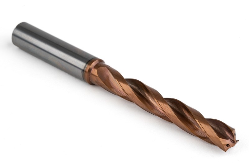

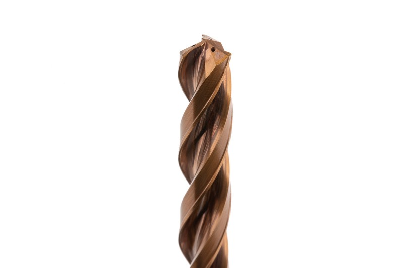

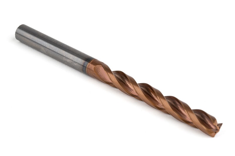

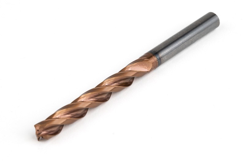

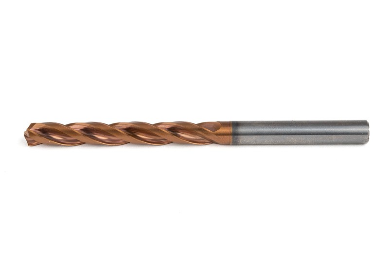

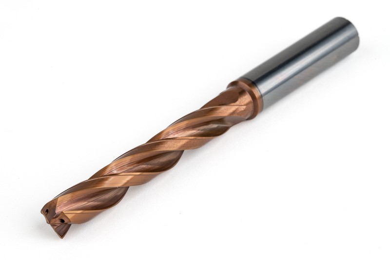

8.6mm Ø Carbide Drill, 10.0mm Shank x 140° Point Angle x 30° Helix, 5XD, 3 Flute, Hybrid AlCrN Coated, HF, TSC
Part #: 03-2291
SC D 3FL 8.6X10X61X103 HYB ALCRN,TSC
Price: 94.95 ( / unit)
Price: 2023.95 ( / unit)
Price: 602.95 ( / unit)
Price: 80.95 ( / unit)
Price: 364.95 ( / unit)
Price: 849.95 ( / unit)
66.97
1424.97
423.97
56.97
256.97
598.97
  • Speeds and Feeds
ISO MATERIAL CHART
Drill Type Decimal
[D1] Drill Diameter 8.6 mm
Material Carbide
Chipbreaker HF - High Feed
Coating Hybrid AlCrN
[ØDMM] Shank Diameter 10.0 mm
[LU] Usable Length 49.0 mm
[LCF] Flute Length 61.0 mm
[PL] Point Length 1.57 mm
[OAL] Overall Length 103.0 mm
[NOF] Number of Flutes 3
[SIG°] Point Angle 140
[FHA°] Helix Angle 30
Length / Diameter 5 X D
Hole Tolerance m7
Cutting Direction Right
Through Spindle Coolant Yes
Weight 0.1 lb \ 0.1 kg
