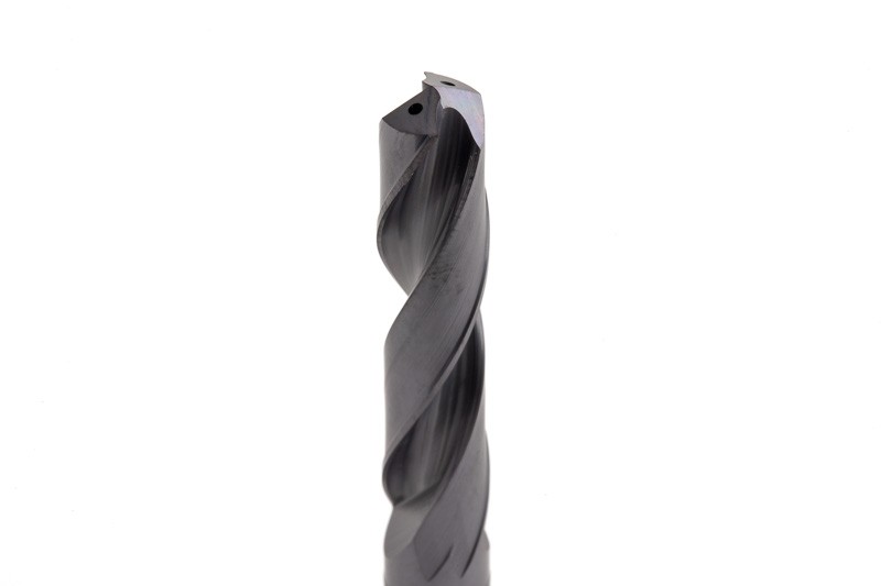

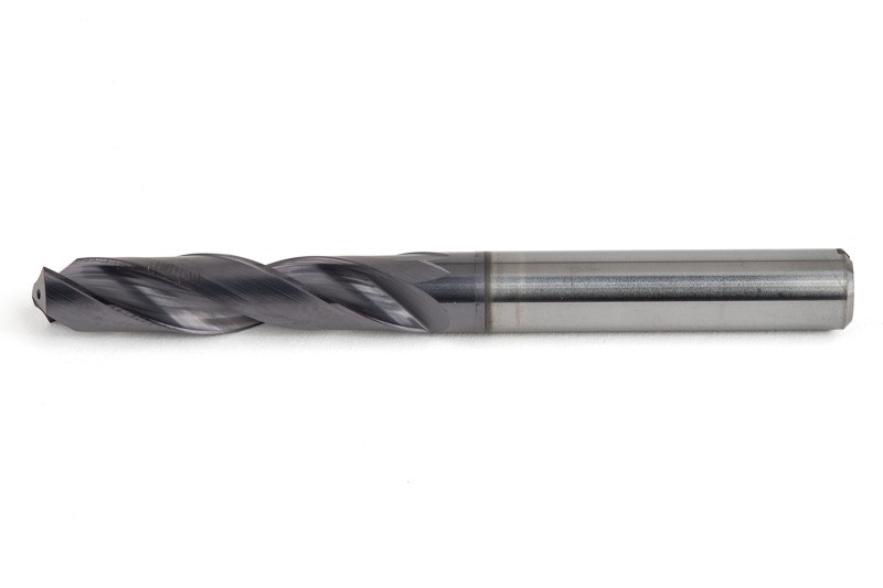

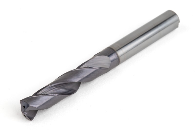

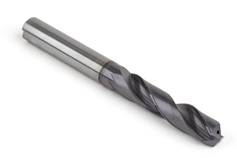

5/16" Ø Carbide Drill, 5/16" Shank x 140° Point Angle x 30° Helix, 3XD, 2 Flute, TiALN Coated, GP, TSC
Part #: 03-2911
SC D 2FL 5/16x5/16x1.614x3.11 TiALN, TSC
Price: 53.95 ( / unit)
37.97
  • Speeds and Feeds
ISO MATERIAL CHART
Drill Type Fraction
[D1] Drill Diameter 0.3125 in \ 5/16"
Secondary Workpiece Material H - Hardened Materials, M - Stainless Steel
Material Carbide
Coating TiAlN
[ØDMM] Shank Diameter 0.3125 in
[LU] Usable Length 1.142 in
[LCF] Flute Length 1.614 in
[PL] Point Length 0.06 in
[OAL] Overall Length 3.11
[NOF] Number of Flutes 2
[SIG°] Point Angle 140
[FHA°] Helix Angle 30
Length / Diameter 3 X D
Hole Tolerance h7
Cutting Direction Right
Through Spindle Coolant Yes
