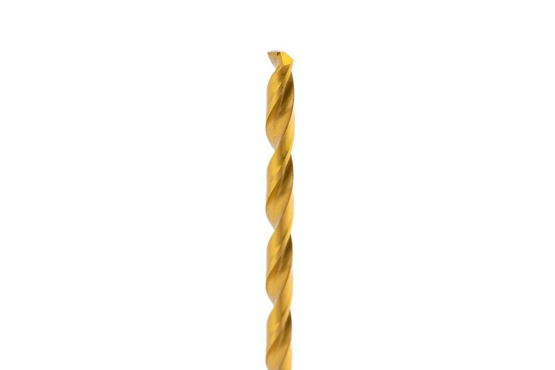

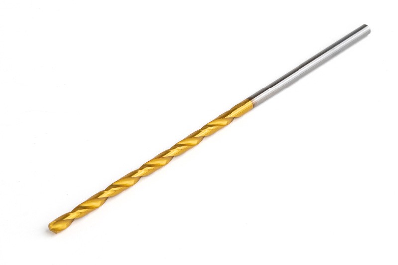

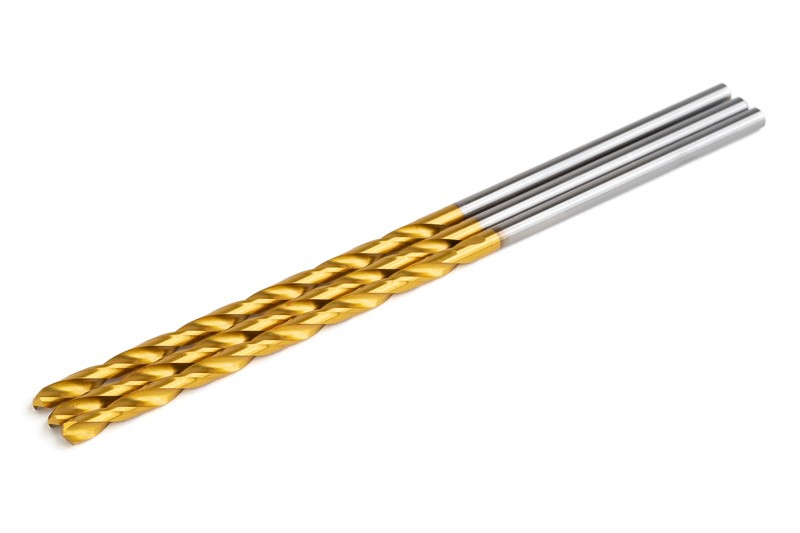

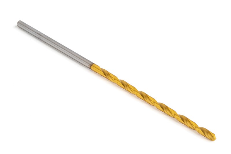

#26 Ø Cobalt Taper-Length Drill, 135° Point Angle x 30° Helix, 2 Flute, TiN Coated - Pack of 3
Part #: 03-2483
CB TD 2FL #26x.147x3x5-3/8 TIN
Price: 18.95 ( / unit)
13.97
Drill Type Number
Primary Workpiece Material M - Stainless Steel, P - Steel
Secondary Workpiece Material S - High Temp Alloys, K - Cast Iron, N - Aluminum
Material HSSCo8 (M42)
Coating TiN
[D1] Drill Diameter 0.147 in \ #26
[ØDMM] Shank Diameter 0.147 in
[LU] Usable Length 2.853 in
[LCF] Flute Length 3.0 in
[PL] Point Length 0.03 in
[OAL] Overall Length 5.375 in
[NOF] Number of Flutes 2
[SIG°] Point Angle 135
[FHA°] Helix Angle 30
Drill Length Type Taper
Hole Tolerance h8
Cutting Direction Right
Through Spindle Coolant No
