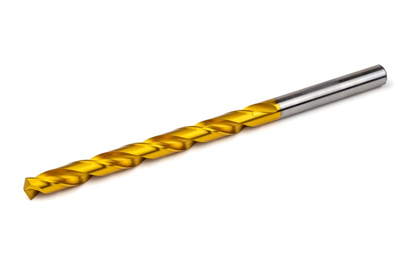

10.5mm Ø Cobalt Taper-Length Drill, 135° Point Angle x 33° Helix, 2 Flute, TiN Coated - Pack of 2
Part #: 03-2763
CB TD 2FL 10.5X10.5X121X184MM TIN

Drill Type Decimal
Secondary Workpiece Material N - Aluminum, K - Cast Iron, S - High Temp Alloys
Material HSSCo8 (M42)
Coating TiN
[D1] Drill Diameter 10.5 mm
[ØDMM] Shank Diameter 10.5 mm
[LU] Usable Length 110.5 mm
[LCF] Flute Length 121.0 mm
[PL] Point Length 2.17 mm
[OAL] Overall Length 184.0 mm
[NOF] Number of Flutes 2
[SIG°] Point Angle 135
[FHA°] Helix Angle 33
Drill Length Type Taper
Hole Tolerance h8
Cutting Direction Right
Through Spindle Coolant No
Weight 0.8 lbs \ 0.4 kg
