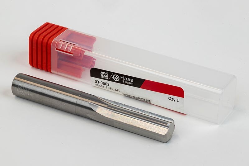

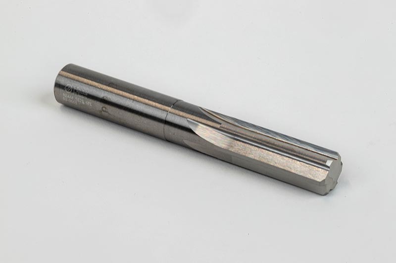

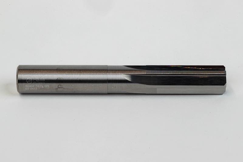

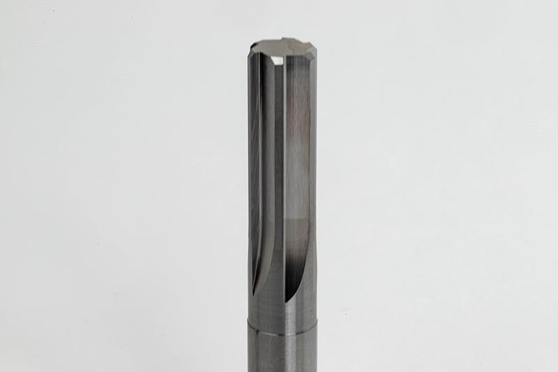

0.5625" Ø Straight Flute Carbide Reamer, 0.5625" Shank x 45° Chamfer Angle, 6 Flute, Right-Hand
Part #: 03-0665
REAMER SF RHC .5625" CARBIDE
Price: 125.95 ( / unit)
88.97
  • Technical Details
ISO Material Chart
Primary Workpiece Material N - Aluminum, P - Steel, H - Hardened Steels, S - High Temp Alloys, K - Cast Iron, M - Stainless Steel
Flute Type Straight Flute
[ØDC] Cutting Diameter 0.5625 in
[ØDMM] Shank Diameter 0.5625 in
[ØN] Neck Diameter 0.553 in
[LU] Usable Length 2.25 in
[LN] Neck Length 0.75 in
[LCF] Flute Length 1.5 in
[OAL] Overall Length 4.0 in
[NOF] Number of Flutes 6
[CHW\RE] Chamfer \ Radius Size 0.035 in
[SIG°] Chamfer Angle 45 Degree
Hole Tolerance +.0003/-.0000 in
Shank Tolerance +.0/-.0005 in
Cutting Direction Right
Through Spindle Coolant No
Weight 0.6 lbs \ 0.3 kg
Country of Origin USA
