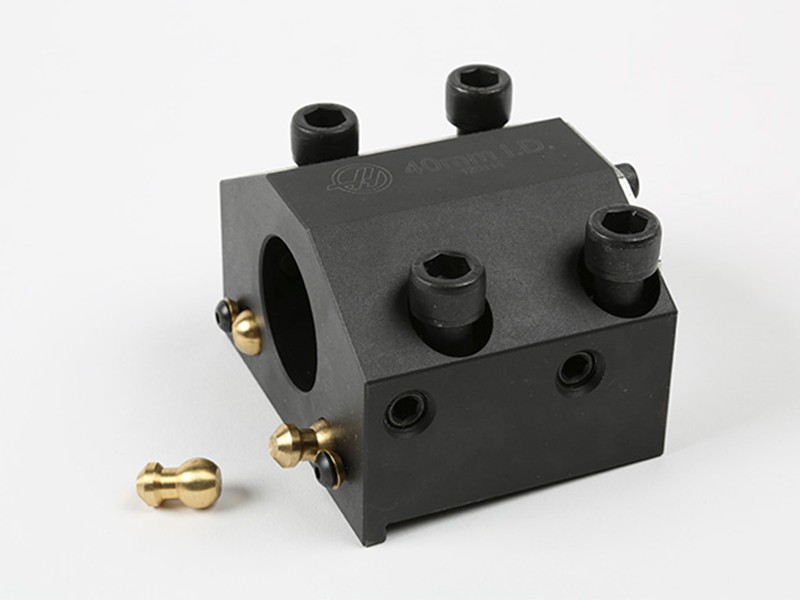

This BOT20 internal (ID) static turning holder securely clamps 40mm round shank tools for use in Haas machines equipped with 12-station BOT20 bolt-on or 12-station VB20/30 hybrid (BOT20/VDI40) turrets.
  • 3D Model
Machine Models ST-35, ST-28, ST-28Y, ST-30LY, ST-30Y, ST-25, ST-30, ST-35Y, ST-25Y, ST-20, ST-20L, ST-20Y, ST-28L, ST-25L, ST-20LY, ST-30L, ST-35LY, ST-35L, ST-28LY, ST-25LY
Turret Style VB Hybrid, Bolt-On
Turret Stations 12-Station
Main Spindle Turret VB20/30, BOT20
Toolholder Series BOT20
Holder Type Internal Turning
[S] Tool Shank Size 40.0 mm
[H] Height 31.75 mm
[BH] Body Height 64.77 mm
[OAL] Overall Length 82.55 mm
[OAW] Overall Width 101.6 mm
[OAH] Overall Height 69.85 mm
[a] Dimension 45.0 mm
[b] Dimension 80.01 mm
[c] Dimension 45.01 mm
[TP1] Thread M12x1.75
[TP2] Thread M12x1.75
Weight 6.0 lbs \ 2.7 kg
