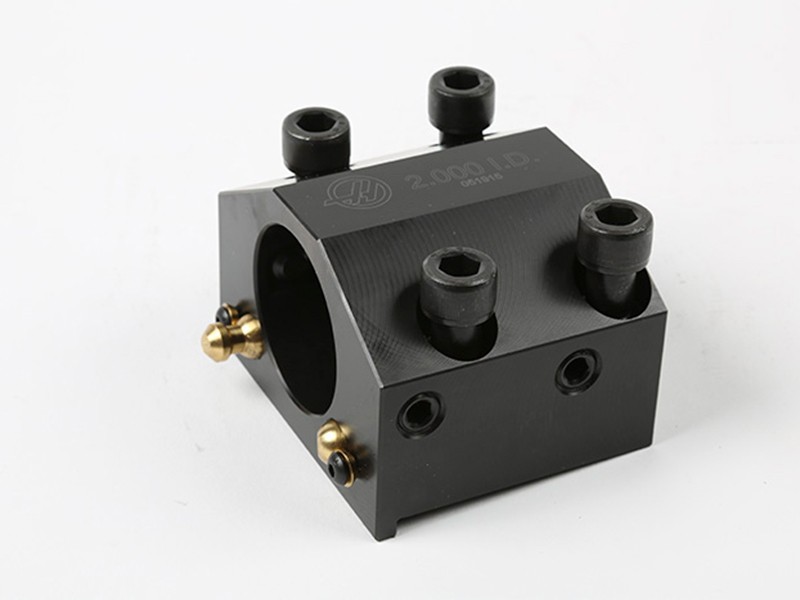

BOT20, 2" Ø Internal (ID) Static Turning Holder
Part #: 04-0755
BOT20ID-2
Price: 461.95 ( / unit)
323.97
This BOT20 internal (ID) static turning holder securely clamps 2.0 in \ 2" round shank tools for use in Haas machines equipped with 12-station BOT20 bolt-on or 12-station VB20/30 hybrid (BOT20/VDI40) turrets.
  • 3D Model
Machine Models ST-25LY, ST-20Y, ST-35Y, ST-20, ST-35LY, ST-30LY, ST-28Y, ST-25, ST-25L, ST-20L, ST-35, ST-30, ST-28, ST-20LY, ST-28LY, ST-30Y, ST-30L, ST-28L, ST-35L, ST-25Y
Turret Style VB Hybrid, Bolt-On
Turret Stations 12-Station
Main Spindle Turret BOT20, VB20/30
Toolholder Series BOT20
Holder Type Internal Turning
[S] Tool Shank Size 2.0 in \ 2"
[H] Height 1.25 in
[BH] Body Height 2.55 in
[OAL] Overall Length 3.25 in
[OAW] Overall Width 4.0 in
[OAH] Overall Height 2.75 in
[a] Dimension 1.772 in
[b] Dimension 3.15 in
[c] Dimension 1.772 in
[TP1] Thread 1/2"-13
[TP2] Thread 1/2"-13
Weight 5.5 lbs \ 2.5 kg
Country of Origin USA
