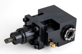

04-0993
BMT45, 90° Radial Live/Driven Turning Holder, Haas Toolholding by BENZ
Part #: 04-0993

04-0994
BMT45, 90° Radial Live/Driven Turning Holder, Haas Toolholding by EXSYS/Eppinger
Part #: 04-0994

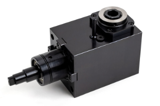

04-0996
BMT45, Straight Axial Live/Driven Turning Holder, Haas Toolholding by BENZ
Part #: 04-0996

04-0997
BMT45, Straight Axial Live/Driven Turning Holder, Haas Toolholding by EXSYS/Eppinger
Part #: 04-0997
