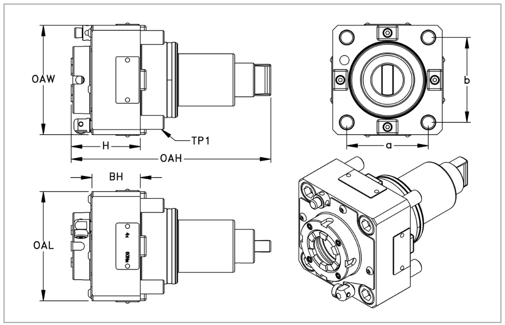

This BMT65 ER32 straight axial live/driven turning holder by EXSYS/Eppinger accepts a variety of ER32 collet styles, for use in Haas machines equipped with 12-station or 24-station BMT65 base mount turrets. The double-taper collet design provides high clamping force for round, smooth shank tools, and offers a wide gripping range with excellent TIR and balance.

[H] Height 2.335 in / 59.3 mm
[BH] Body Height 1.634 in / 41.5 mm
[OAL] Overall Length 3.701 in / 94.0 mm
[OAW] Overall Width 3.701 in / 94.0 mm
[OAH] Overall Height 6.744 in / 171.3 mm
[a] Dimension 2.756 in / 70.0 mm
[b] Dimension 2.874 in / 73.0 mm
[TP1] Thread M12x1.75
Maximum RPM 6000
Brand EXSYS Eppinger
Weight 8.0 lbs \ 3.6 kg
Country of Origin Germany
