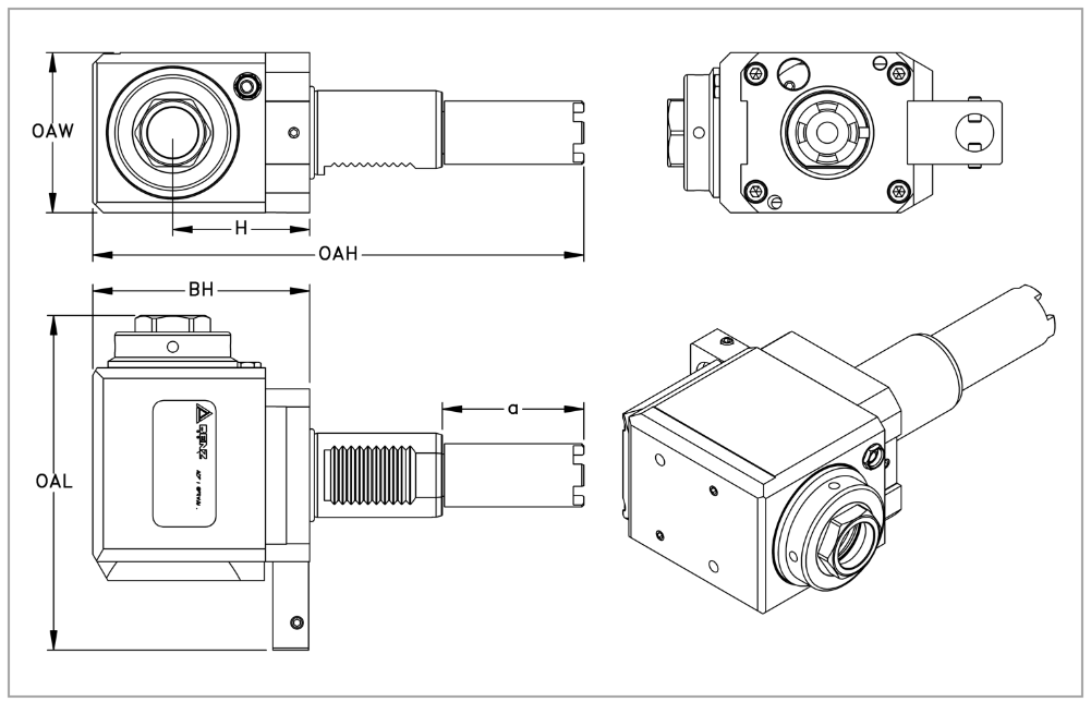

This VDI40 ER32 90-degree radial extended live/driven turning holder by BENZ accepts a variety of ER32 collet styles, for use in Haas machines equipped with 12-station VB40 hybrid (BOT40/VDI40) turrets. The double-taper collet design provides high clamping force for round, smooth shank tools, and offers a wide gripping range with excellent TIR and balance.
**For legacy Haas HL, SL, ST, and TL machines, verify the 'a dimension' specification accurately locates the VDI40 holder shank to the turret's gear drive system.
Refer to the Lathe Toolholder Selection Chart to ensure your machine turret matches.
  • Technical Documents
  • Driven (Live) Tool Heads
  • Warranty Information
System of Measurement Inch - ANSI, Metric - ISO
Machine Models ST-45, ST-40, ST-45L, ST-40L
Turret Style VB Hybrid
Turret Stations 12-Station
Main Spindle Turret VB40
Toolholder Series VDI40 Extended Coupling
Holder Type 90-Degree
Collet Series ER-32
[H] Height 2.559 in / 65.0 mm
[BH] Body Height 4.055 in / 103.0 mm
[OAL] Overall Length 6.256 in / 158.9 mm
[OAW] Overall Width 2.992 in / 76.0 mm
[OAH] Overall Height 9.183 in / 233.25 mm
[a] Dimension 2.648 in / 67.25 mm
Maximum RPM 6000
Brand BENZ Tooling
Weight 18.3 lbs \ 8.3 kg
Country of Origin Germany
