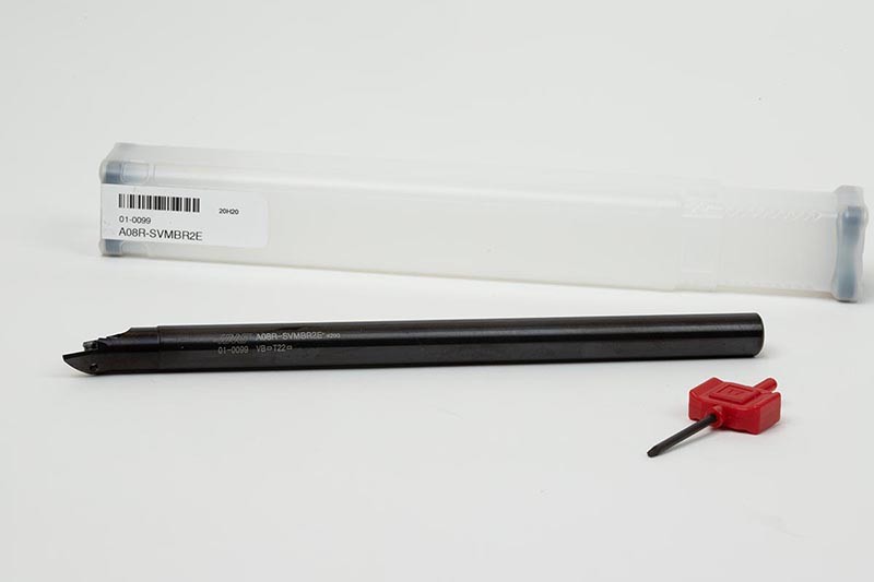

A08R-SVMBR2E, 1/2" Ø Steel Shank Internal (ID) Boring Bar, Right-Hand, Screw-Lock, Through-Tool Coolant
Part #: 01-0099
A08R-SVMBR2E
Price: 90.95 ( / unit)
63.97
Technical Documents
Type of Bar A - Steel Bar + Coolant
Clamping Type S - Screw-On
Tool Orientation Internal
Hand of Tool Right
Insert Style V Style - 35° Rhombic

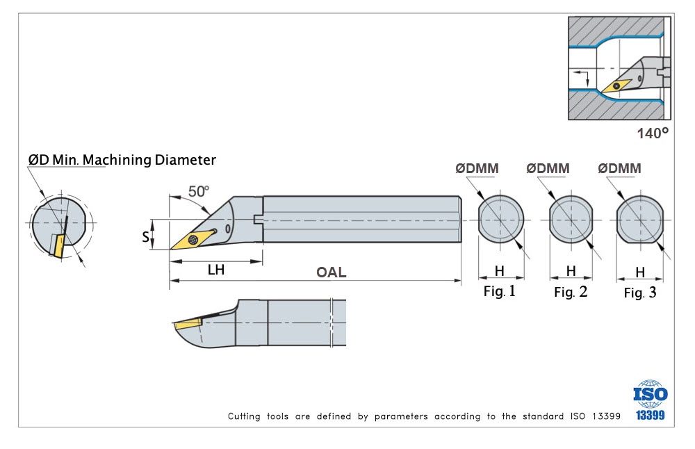

Insert Size VBㅁㅁ22ㅁ / VBㅁㅁ1103ㅁㅁ
[ØD] Min. Machining Diameter 0.98 in
[ØDMM] Shank Diameter 0.5 in
[LH] Head Length 1.063 in
[OAL] Overall Length 8.0 in
[H] Shank Height  0.48 in
[S] Center to Insert Dimension 0.312 in
[°] Lead Angle 140 Degree
[IC] Inscribed Circle Diameter 0.25 in \ 6.35 mm
[D1] Insert Hole Size 0.11 in \ 2.8 mm
Figure 1
Through Tool Coolant Yes
Weight 0.4 lbs \ 0.2 kg
