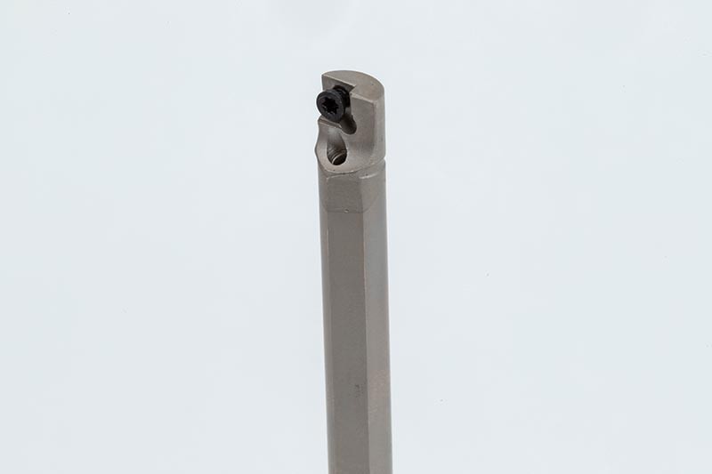

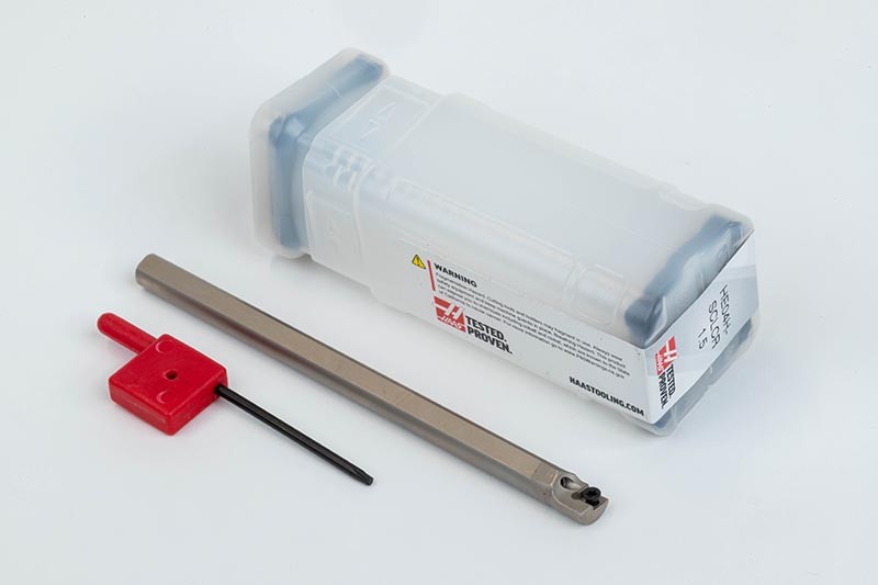

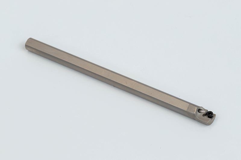

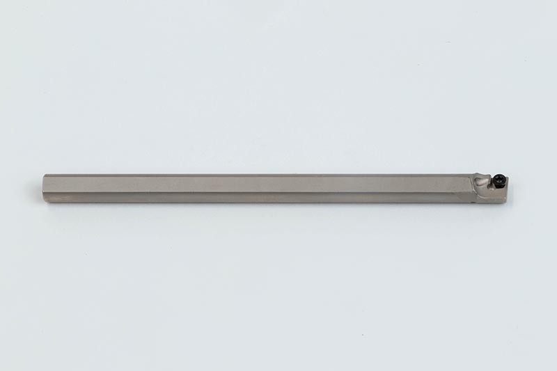

E04H-SCLCR1.5, 1/4" Ø Carbide Shank Internal (ID) Boring Bar, Right-Hand, Screw-Lock, Through-Tool Coolant
Part #: 01-0256
HE04H-SCLCR1.5
Price: 136.95 ( / unit)
95.97
Type of Bar E - Carbide Shank + Coolant
Clamping Type S - Screw-On
Tool Orientation Internal
Hand of Tool Right
Insert Size CCㅁㅁ151ㅁ / CCㅁㅁ0401ㅁㅁ
[ØD] Min. Machining Diameter 0.321 in
[ØDMM] Shank Diameter 0.25 in
[OAL] Overall Length 4.0 in
[H] Shank Height  0.23 in
[S] Center to Insert Dimension 0.156 in
[°] Lead Angle 95 Degree
[IC] Inscribed Circle Diameter 0.169 in \ 4.3 mm
[D1] Insert Hole Size 0.09 in \ 2.3 mm
Figure 1
Through Tool Coolant Yes
