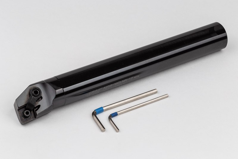

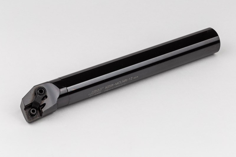

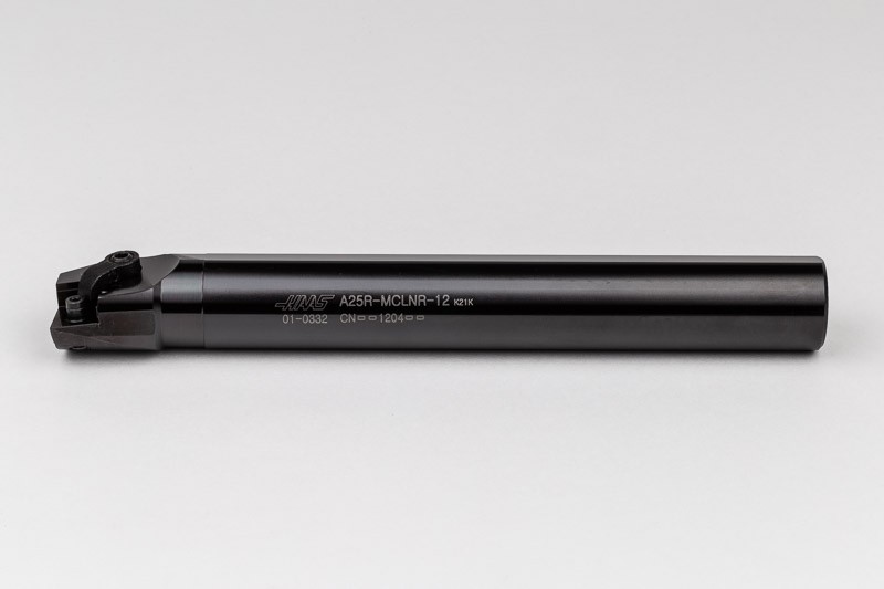

A25R-MCLNR-12, 25mm Ø Steel Shank Internal (ID) Boring Bar, Right-Hand, Multi-Lock, Through-Tool Coolant
Part #: 01-0332
A25R-MCLNR-12
Price: 152.95 ( / unit)
Price: 2773.95 ( / unit)
Price: 825.95 ( / unit)
Price: 110.95 ( / unit)
Price: 499.95 ( / unit)
Price: 1164.95 ( / unit)
107.97
1949.97
580.97
77.97
350.97
818.97
Type of Bar A - Steel Bar + Coolant
Clamping Type M - Multi-Lock
Tool Orientation Internal
Hand of Tool Right
Insert Size CNㅁㅁ43ㅁ / CNㅁㅁ1204ㅁㅁ
[ØD] Min. Machining Diameter 32.0 mm
[ØDMM] Shank Diameter 25.0 mm
[LH] Head Length 40.0 mm
[OAL] Overall Length 200.0 mm
[H] Shank Height  24.0 mm
[S] Center to Insert Dimension 17.0 mm
[°] Lead Angle 95 Degree
[L10] Cutting Edge Length 0.508 in \ 12.9 mm
Figure 1
Through Tool Coolant Yes
Weight 1.5 lbs \ 0.7 kg
