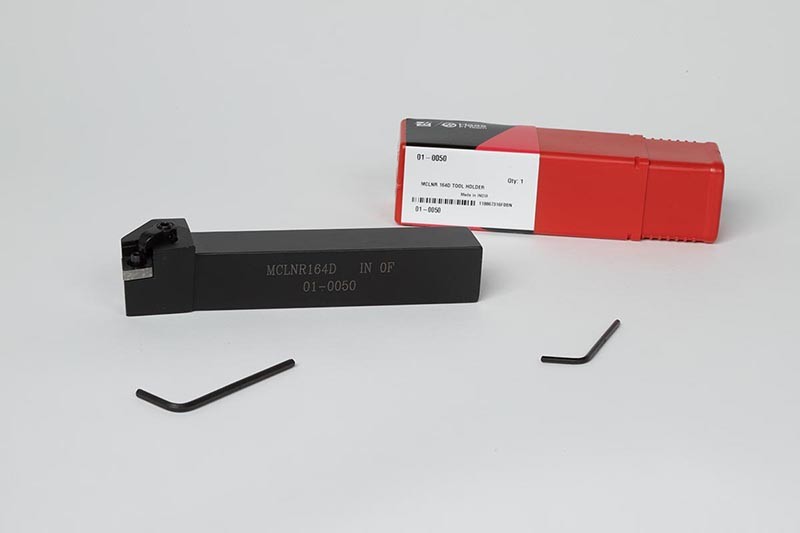

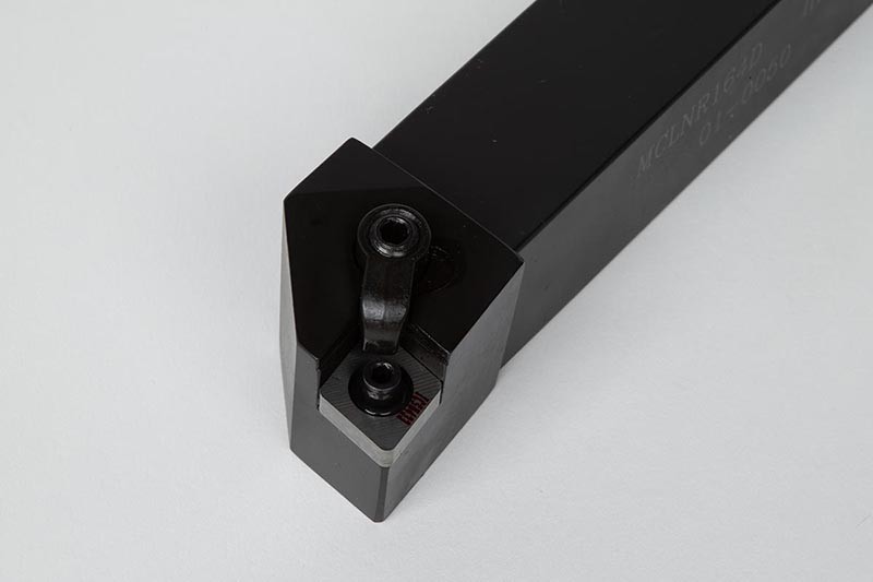

MCLNR16-4D, 1" Square Steel Shank External (OD) Turning Tool, Right-Hand, Multi-Lock
Part #: 01-0050
MCLNR 164D TOOL HOLDER
Price: 94.95 ( / unit)
Technical Documents
Clamping Type M - Multi-Lock
Tool Orientation External
Hand of Tool Right
[LH] Head Length 1.12 in
[OAL] Overall Length 6.0 in
[H1] Cutting Height 1.0 in
[H] Shank Height 1.0 in
[B] Shank Width 1.0 in
[f] Dimension 1.25 in
[°] Lead Angle 95 Degree
Machine Side Adapter Type Square Shank
Through Tool Coolant No
Weight 1.6 lbs \ 0.7 kg
Country of Origin India
