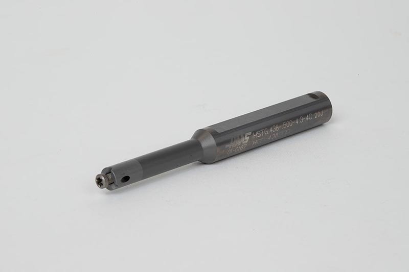

HSTG.433-.313-3.2-4C, 5/16" Ø Carbide Shank Small Internal (ID) Grooving/Threading Bar, Insert Size 4, Through-Tool Coolant
Part #: 01-0166
RETAIL PRICE: $103.95
$77.97
HSTG.433-.500-4.3-4C, 1/2" Ø Carbide Shank Small Internal (ID) Grooving/Threading Bar, Insert Size 4, Through-Tool Coolant
Part #: 01-0167
RETAIL PRICE: $115.95
$86.97
