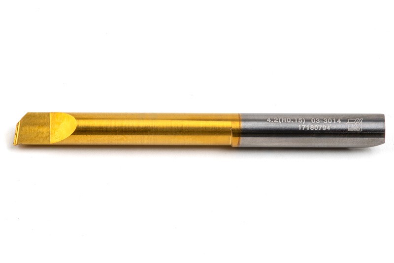

HMBCB-4, 4mm Ø Carbide Internal (ID) Micro Boring/Profiling (+CB) Tool, 4.2mm Min. Dia. x 25mm Head Length, Right-Hand
Part #: 03-3014
MICRO TURN, HMBCB-4R4.2-25-15 TIN
Price: 27.95 ( / unit)
Price: 573.95 ( / unit)
Price: 170.95 ( / unit)
Price: 22.95 ( / unit)
Price: 103.95 ( / unit)
Price: 240.95 ( / unit)
19.97
ISO MATERIAL CHART
Type Tool
Toolpath Type ID Turn
Tool Orientation Internal
Hand of Tool Right
Insert Style HMBCB - Boring w/Chip Breaker
Secondary Workpiece Material S - High Temp Alloys, M - Stainless Steel
Material Carbide
Coating TiN
Connection Size 4
[ØD] Min. Machining Diameter 0.165 in \ 4.2 mm
[ØDMM] Shank Diameter 0.157 in \ 4.0 mm
[LH] Head Length 0.984 in \ 25.0 mm
[OAL] Overall Length 1.693 in \ 43.0 mm
[OHX] Maximum Overhang 1.1 in \ 28.0 mm
[RE] Corner Radius 0.006 in \ 0.15 mm
[T-MAX] Maximum Depth 0.012 in \ 0.3 mm
[S] Center to Insert Dimension 0.077 in \ 1.95 mm
