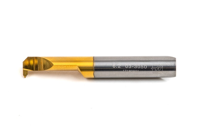

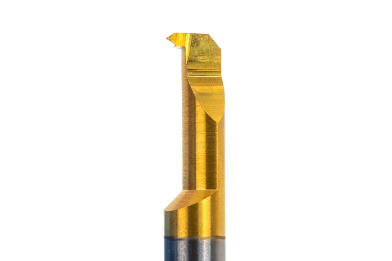

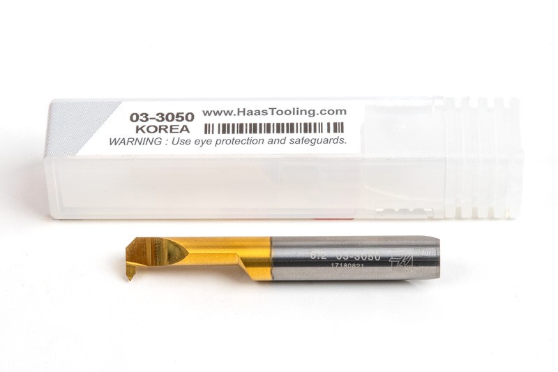

HMTH-6, 6mm Ø Carbide Internal (ID) Micro Partial Profile 60° Threading Tool, 1.0 - 1.25 Pitch, Right-Hand
Part #: 03-3050
MICRO TURN, HMTH-6R6.2-15-100 TIN
Price: 34.95 ( / unit)
Price: 748.95 ( / unit)
Price: 222.95 ( / unit)
Price: 29.95 ( / unit)
Price: 134.95 ( / unit)
Price: 314.95 ( / unit)
22.97
ISO MATERIAL CHART
Type Tool
Toolpath Type ID Thread
Tool Orientation Internal
Hand of Tool Right
Insert Style HMTH - Threading
Secondary Workpiece Material M - Stainless Steel, S - High Temp Alloys
Material Carbide
Coating TiN
Connection Size 6
Thread Type Partial Profile 60°
[TP] Thread Pitch 1.0 - 1.25 mm
[HA] Thread Height 0.031 in \ 0.8 mm
[ØD] Min. Machining Diameter 0.244 in \ 6.2 mm
[ØDMM] Shank Diameter 0.236 in \ 6.0 mm
[LH] Head Length 0.591 in \ 15.0 mm
[OAL] Overall Length 1.693 in \ 43.0 mm
[OHX] Maximum Overhang 0.81 in \ 20.5 mm
[RE] Corner Radius 0.005 in \ 0.12 mm
[S] Center to Insert Dimension 0.116 in \ 2.95 mm
[F] Dimension 0.020 in \ 0.51 mm
