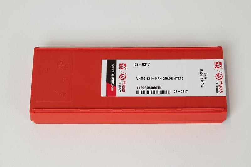

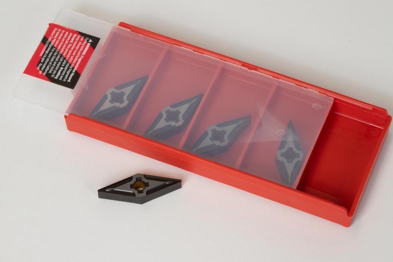

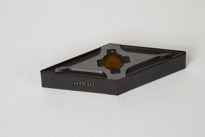

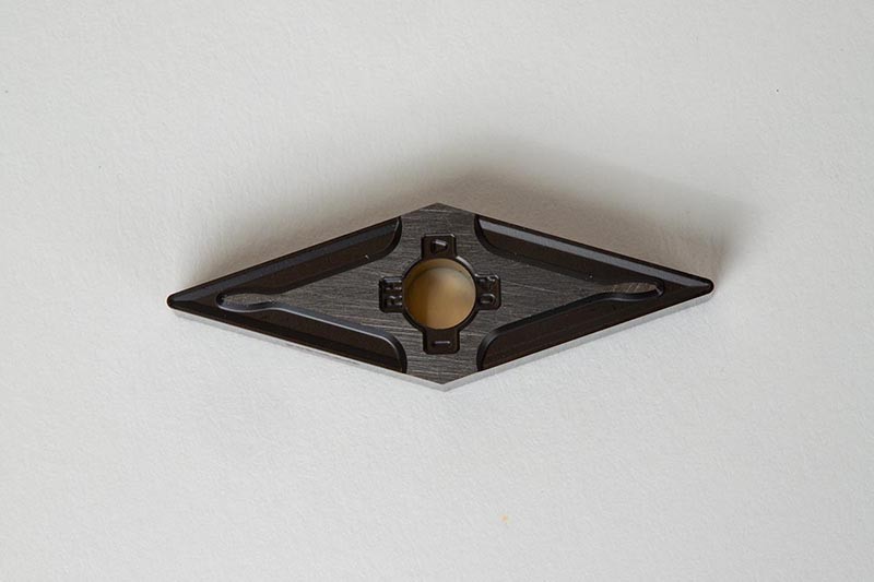

VNMG331-HRH / VNMG160404-HRH, Carbide Turning Insert, 35° Rhombic, Grade HTK10 - Pack of 5
Part #: 02-0217
VNMG 331-HRH HTK10
Price: 23.95 ( / unit)
Price: 423.95 ( / unit)
Price: 126.95 ( / unit)
Price: 16.95 ( / unit)
Price: 76.95 ( / unit)
Price: 177.95 ( / unit)
19.97
ISO Material Chart
Clamping Type M - Multi-Lock, D - Double-Clamp
Insert Style V Style - 35° Rhombic
Primary Workpiece Material K - Cast Iron
Secondary Workpiece Material P - Steel
Grade HTK10 - Light Interrupted
Material Carbide
Chipbreaker HRH - Roughing Heavy
Chipbreaker (Old Designation) HMP
[D1] Insert Hole Size 0.15 in \ 3.81 mm
[L10] Cutting Edge Length 0.654 in \ 16.61 mm
[RE] Corner Radius 0.0157 in \ 0.4 mm
Country of Origin India
