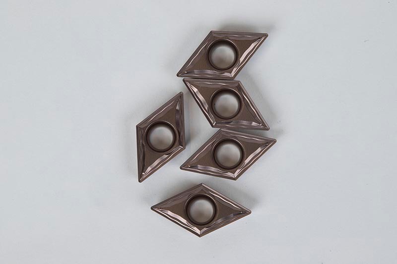

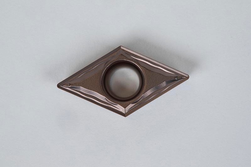

DCMT3251-HFP / DCMT11T304-HFP, Carbide Turning Insert, 55° Rhombic, Grade HTM15 - Pack of 5
Part #: 02-0367
DCMT 3251-HFP HTM15
Customer Rating:
Price: $18.95 ($3.79 / unit)
Each pack contains (5) units. Units not sold individually.
Price: 362.95 ( / unit)
Price: 103.95 ( / unit)
Price: 13.95 ( / unit)
Price: 62.95 ( / unit)
Price: 146.95 ( / unit)
$18.00 (Save 5%)
ISO Material Chart
Clamping Type S - Screw-On
Insert StyleThe shape of the insert: round, square, diamond, octagonal, etc. The shape of the insert defines the point angle, which determines the strength of the cutting edge, the ability to cut fine features, and the number of indexable cutting edges available. D Style - 55° Rhombic
Primary Workpiece Material M - Stainless Steel
Secondary Workpiece Material P - Steel, S - High Temp Alloys
GradeThe type of coating on the insert, which determines the toughness and wear resistance of the insert, as well as the types of material for which the insert can be used. HTM15 - Light Interrupted
Material Carbide
Chipbreaker HFP - Finishing Positive
[D1] Insert Hole Size 0.173 in \ 4.4 mm
[L10] Cutting Edge Length 0.458 in \ 11.63 mm
[S] Insert Thickness 0.156 in \ 3.97 mm
[RE] Corner Radius 0.0157 in \ 0.4 mm
Country of Origin India
