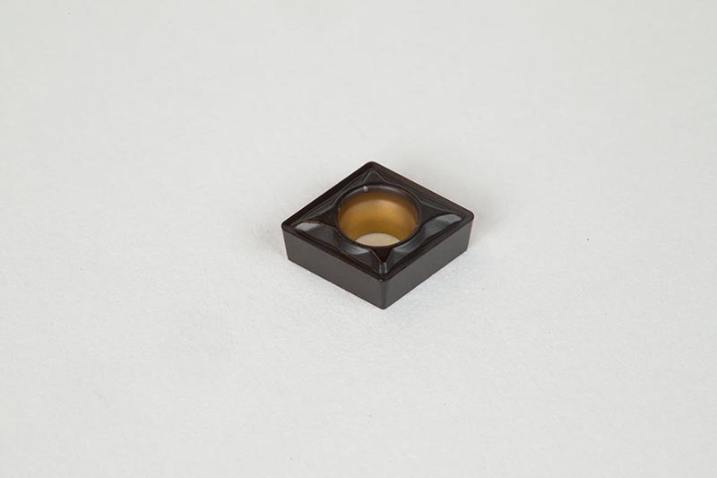

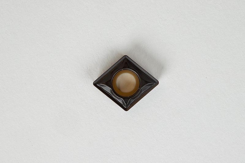

CCMT2151-HFP / CCMT060204-HFP, Carbide Turning Insert, 80° Rhombic, Grade HTK20 - Pack of 5
Part #: 02-0385
CCMT 2151-HFP HTK20
Price: 16.95 ( / unit)
Price: 310.95 ( / unit)
Price: 88.95 ( / unit)
Price: 11.95 ( / unit)
Price: 53.95 ( / unit)
Price: 125.95 ( / unit)
14.97
ISO Material Chart
Clamping Type S - Screw-On
Primary Workpiece Material K - Cast Iron
Secondary Workpiece Material P - Steel
Grade HTK20 - Medium Interrupted
Material Carbide
Chipbreaker HFP - Finishing Positive
[IC] Inscribed Circle Diameter 0.25 in \ 6.35 mm
[D1] Insert Hole Size 0.11 in \ 2.8 mm
[L10] Cutting Edge Length 0.254 in \ 6.45 mm
[S] Insert Thickness 0.094 in \ 2.38 mm
[RE] Corner Radius 0.0157 in \ 0.4 mm
Country of Origin India
