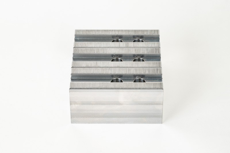

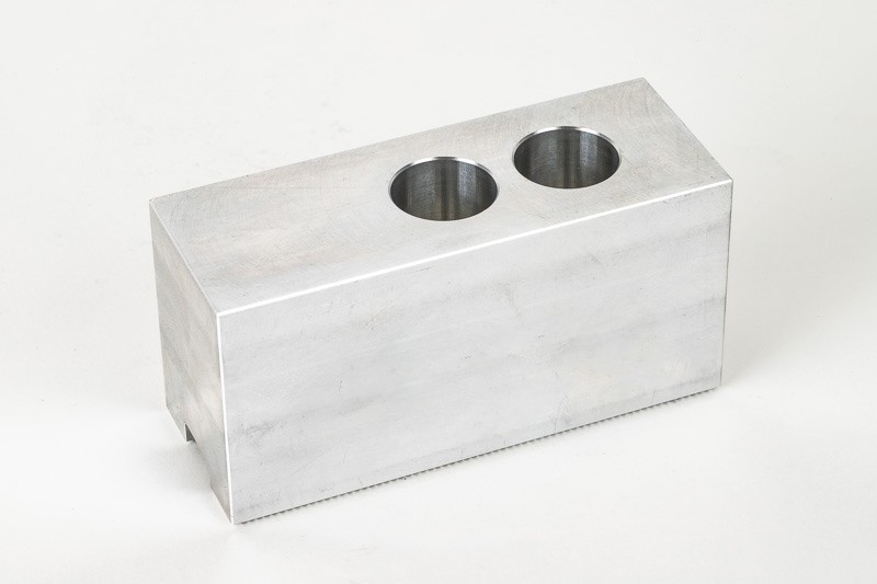

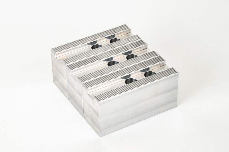

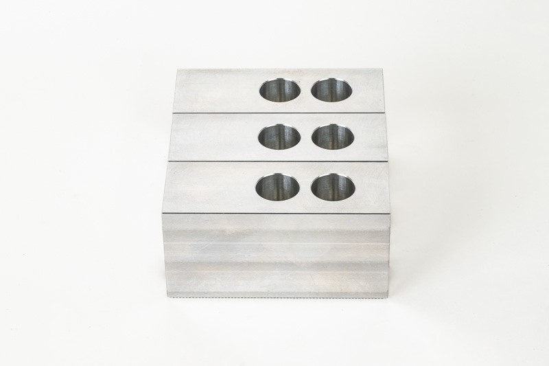

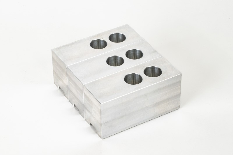

Aluminum Machinable Lathe Jaws for 8" (210mm) Chuck, Standard Flat, 3 Pc. Set
Part #: 05-0140
LATHE JAW-8"-SF-ALUM-L4XW1.5XH2"

*These jaws are for hydraulic power chucks with fine jaw serrations.  These are standard on Haas ST and DS models.  Haas Toolroom Lathes, TL-1 and TL-2, use manual scroll-type chucks with different jaws.

Chuck Size 8.0 in \ 210.0 mm
Material Aluminum
End Type Standard Flat
[ØD2] Screw Hole Diameter 0.531 in \ 13.5 mm
[ØD1] Counterbore Diameter 0.781 in \ 19.8 mm
[ØBD] Body Diameter N/A
[D] Groove Width 0.551 in \ 14.0 mm
[OAL] Overall Length 4.0 in \ 101.6 mm
[OAW] Overall Width 1.5 in \ 38.1 mm
[OAH] Overall Height 2.0 in \ 50.8 mm
[S] Screw Spacing 0.984 in \ 25.0 mm
Serration Size 1.5 mm x 60°
Weight 3.0 lbs \ 1.3 kg
