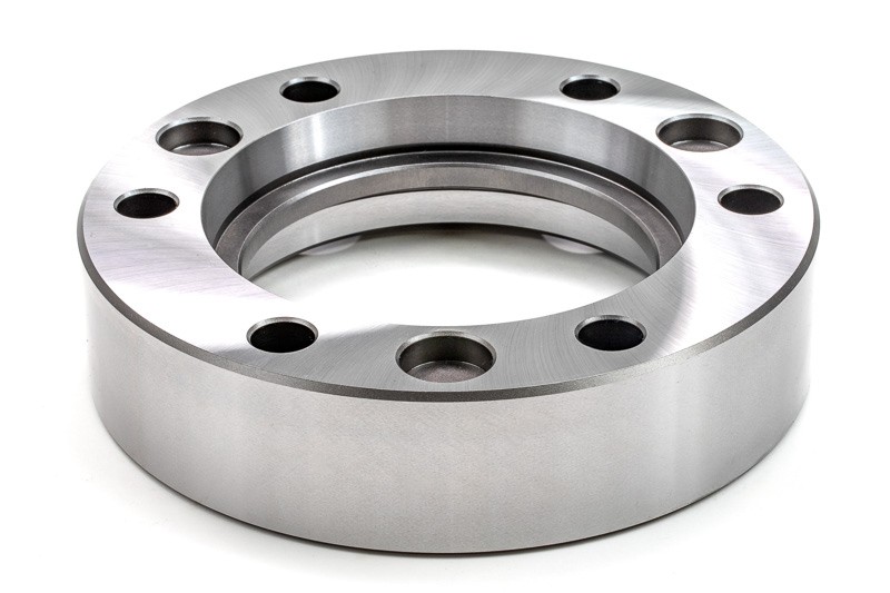

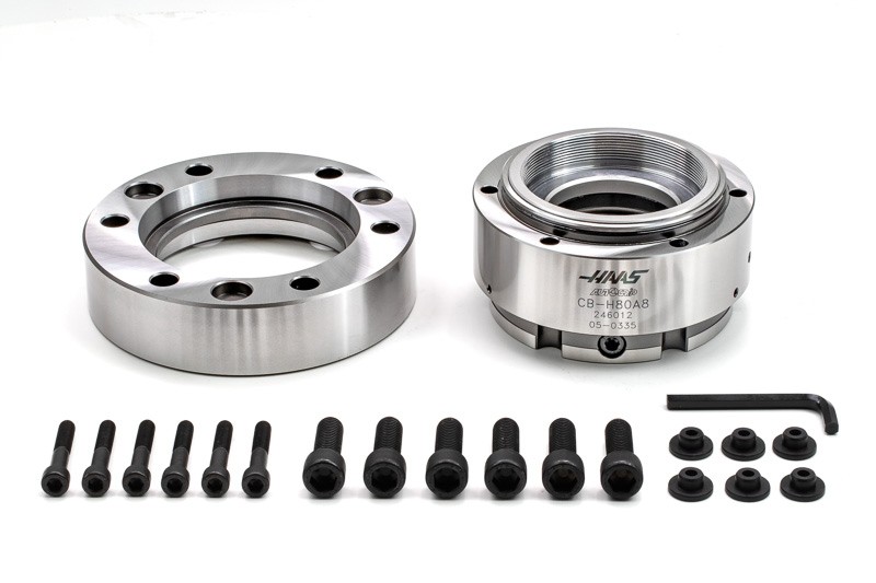

Reduce your lathe set-up times with this Haas quick-change collet chuck. Collets are changed in seconds, using a handheld collet changing tool (not included), making the changeover from one size material to another fast and easy. This pull-back style A2-8 collet chuck is compatible with Haas ST-28 and ST-35 lathes. Accepts a wide range of quick-change collets, in smooth and serrated styles (not included).
Haas Collet Chuck 80
____________________________
  • Pull back collet chuck
  • Compatible with Haas ST-28 and ST-35 with 4.0" (101.6mm) bar capacity, including long-bed versions and Y-axis
  • Collet changes in seconds (requires handheld collet changing tool)
  • High clamping accuracy and rigidity
  • Sealed design for long life and minimal maintenance
  • Uses rubber grip collets for better grip and larger gripping range
*VERIFY YOUR DRAWTUBE THREAD SIZE*
This collet chuck will only fit on Haas ST-28 and ST-35 Lathes that feature an M115 thread. Please refer to the layout drawing of your machine to verify the drawtube thread and ensure an accurate fit.
Disclaimer: Spindle Reduction Sleeves / Liners length may need to be modified.

Type Collet Chuck
Collet Type Pull Back Collet Chuck
Machine Models ST-35Y, ST-35L, ST-28L, ST-35, ST-28Y, ST-28
Collet Series HRG-80RT, HRG-80R
Spindle Nose A2-8
[ØD] Bore Diameter 3.25 in \ 82.5 mm
[ØBD] Body Diameter 6.89 in \ 175.0 mm
[ØA] Flange Diameter 8.27 in \ 210.0 mm
[ØB] Nose Diameter 6.1 in \ 155.0 mm
[ØF] Spindle Nose Diameter 5.5 in \ 139.72 mm
[C] Flange Length 1.97 in \ 50.0 mm
[E] Nose Length 0.86 in \ 22.0 mm
[OAL] Overall Length 4.92 in \ 125.0 mm
[G] Throat Depth 1.65 in \ 42.0 mm
Draw Nut Thread Size M115x2.0
Concentricity 0.0004 in \ 0.01 mm
Maximum Collet Capacity 3.15 in \ 80.0 mm
Minimum Collet Capacity 0.157 in \ 4.0 mm
Maximum RPM 5500
Maximum Clamping Force 23155.3 lbs \ 103.0 kN
Weight 41.9 lbs \ 19.0 kg
