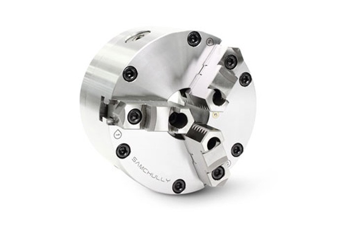

8" (203mm) 3-Jaw Scroll Chuck, A2-6 Spindle Nose
Part #: 05-0807
MC8-6
Price: 1899.95 ( / unit)
This 8" (203 mm) Manual 3-Jaw Scroll Chuck features removable hard top jaws, an A2-6 mount, and a 2.3" (58 mm) through-bore. It accommodates both OD and ID clamping, and has a maximum speed rating of 3500 rpm. The chuck is self-centering, with an industry-standard tongue-and-groove design. The spindle adapter and chuck key are included.
Machine Models TL-2, TL-1
Spindle Nose A2-6
Jaw Style Two-Piece
Number of Jaws 3
Material Steel
[ØBHC] BHC Diameter 5.25 in \ 133.35 mm
[ØCD] Chuck Diameter 8.0 in \ 203.0 mm
[ØID] Inner Diameter 2.3 in \ 58.0 mm
[BL] Body Length 3.1 in \ 78.7 mm
[OAL] Overall Length 4.8 in \ 121.5 mm
[TP1] Thread 1/2"-13
Maximum RPM 3500
Maximum Clamping Force 31000 N
Max O.D. Clamping 0.2 - 7.0 in
Max I.D. Clamping 2.2 - 6.6 in
Torque of Wrench 107.9 Nm
Weight 47.7 lbs \ 21.6 kg
