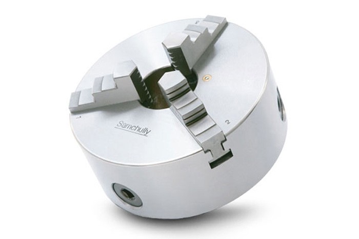

10" (254mm) 3-Jaw Scroll Chuck, A2-6 Spindle Nose
Part #: 05-0808
MC10
Price: 2099.95 ( / unit)
This 10" (254 mm) Manual 3-Jaw Scroll Chuck features removable hard top jaws, an A2-6 mount, and a 3.0" (76 mm) through-bore. It accommodates both OD and ID clamping, and has a maximum speed rating of 2500 rpm. The chuck is self-centering, with an industry-standard tongue-and-groove design. The spindle adapter and chuck key are included.
Machine Models TL-2, TL-1
Spindle Nose A2-6
Jaw Style One-Piece
Number of Jaws 3
Material Steel
[ØBHC] BHC Diameter 5.25 in \ 133.35 mm
[ØCD] Chuck Diameter 10.0 in \ 254.0 mm
[ØID] Inner Diameter 3.0 in \ 76.0 mm
[BL] Body Length 3.5 in \ 88.0 mm
[OAL] Overall Length 5.74 in \ 145.82 mm
[TP1] Thread 1/2"-13
Maximum RPM 2500
Maximum Clamping Force 46000 N
Max O.D. Clamping 0.2 - 10.2 in
Max I.D. Clamping 2.8 to 9.8 in
Torque of Wrench 176.5 Nm
Weight 92.7 lbs \ 42.0 kg
