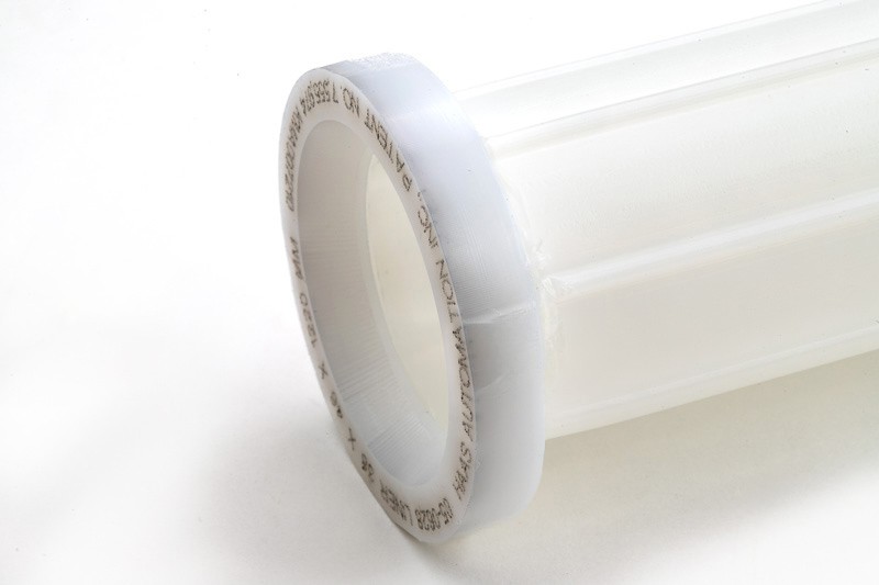

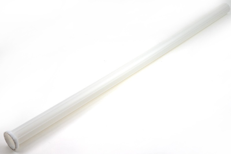

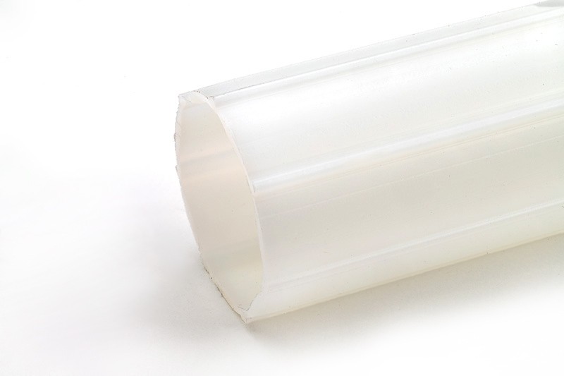

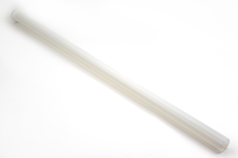

Haas 1.06m Extruded Spindle Liner, 38mm Bore Diameter x 45mm External Diameter, for Round Bar Stock
Part #: 05-0628
LINER 38 X 46 X 1220 MM
Price: 157.95 ( / unit)
Haas spindle liners provide extra stability to bar stock during turning operations. Made from durable extruded high-density polyethylene, these spindle liners are an easy and inexpensive tool to utilize around the workshop. With a 38mm internal bore and a 45mm interference fit external diameter, these spindle liners are engineered to decrease vibration and maximize workflow with the use of the Haas Bar Feeder.
Type Liner
Machine Models ST-10, ST-10Y
Nominal Bore Diameter 38.0 mm
Nominal External Diameter 45.0 mm
[ØD] Bore Diameter 38.48 +0.25 / -0.00 mm
[ØED] External Diameter 46.1 ±0.254 mm
[ØA] Head Diameter 58.9 mm
[BL] Body Length 1066.8 mm
[OAL] Overall Length 1076.45 mm
Weight 1.4 lbs \ 0.6 kg
